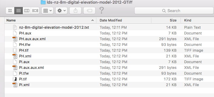

1. DEM: See Screen shot for the contents within the extracted DEM folder
Process: I have copied this folder and all of its contents into the data folder in my CE navigator. Then I dragged and dropped the PI.tif file into my scene. This created a height map. The values being min -2, max +18.
Question: I can't see any variation in the terrain? Is it too subtle to notice or have I not imported correctly?

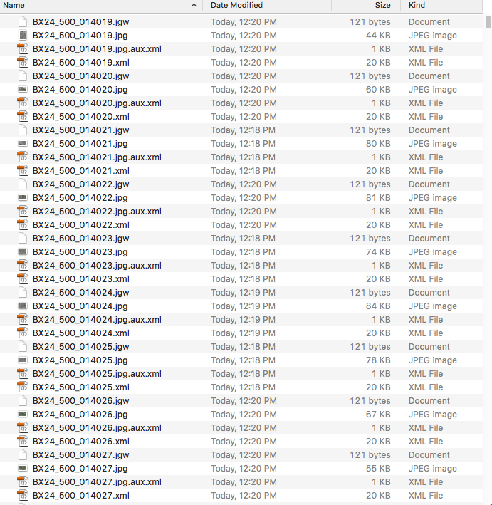

2. Aerial Imagery: The aerial imagery data I have downloaded looks as follows.
Question: Can I simply stitch the .jpg files together in Photoshop and ignore the other files. Then bring in this JPEG file into CE by itself to be used as my texture map to link with the DEM above. The extents of the areas downloaded for DEM and Aerial imagery are the same.
