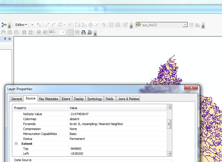

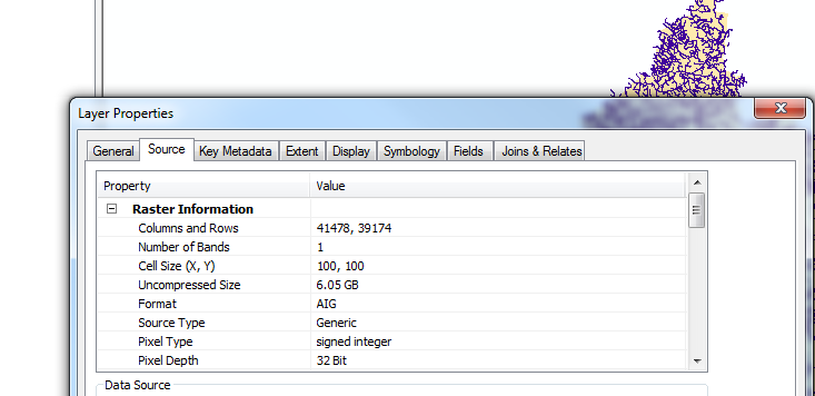

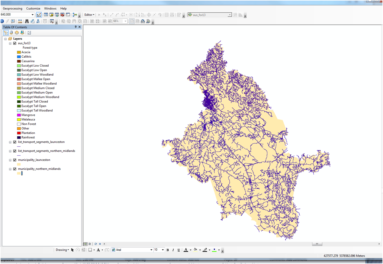

When I import the data into ArcMap, the layer does not display. Arc appears to recognize the extent, because when I Zoom To Layer it snaps to the scale of the entire continent. I've zoomed into the region of Tasmania containing my study area in the map below. The background data layers are the municipalities and road segments. The forest layer should be overlain, but it isn't, as you can see:
See the layer properties:

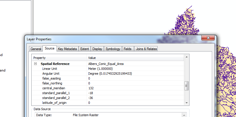

More properties:
Datum: D_GDA_1994

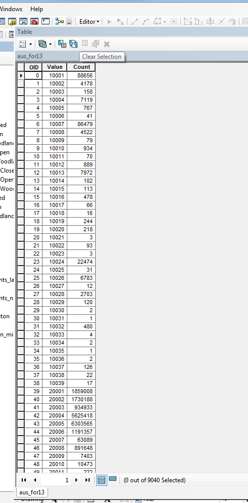

Attributes appear to be missing as well.
