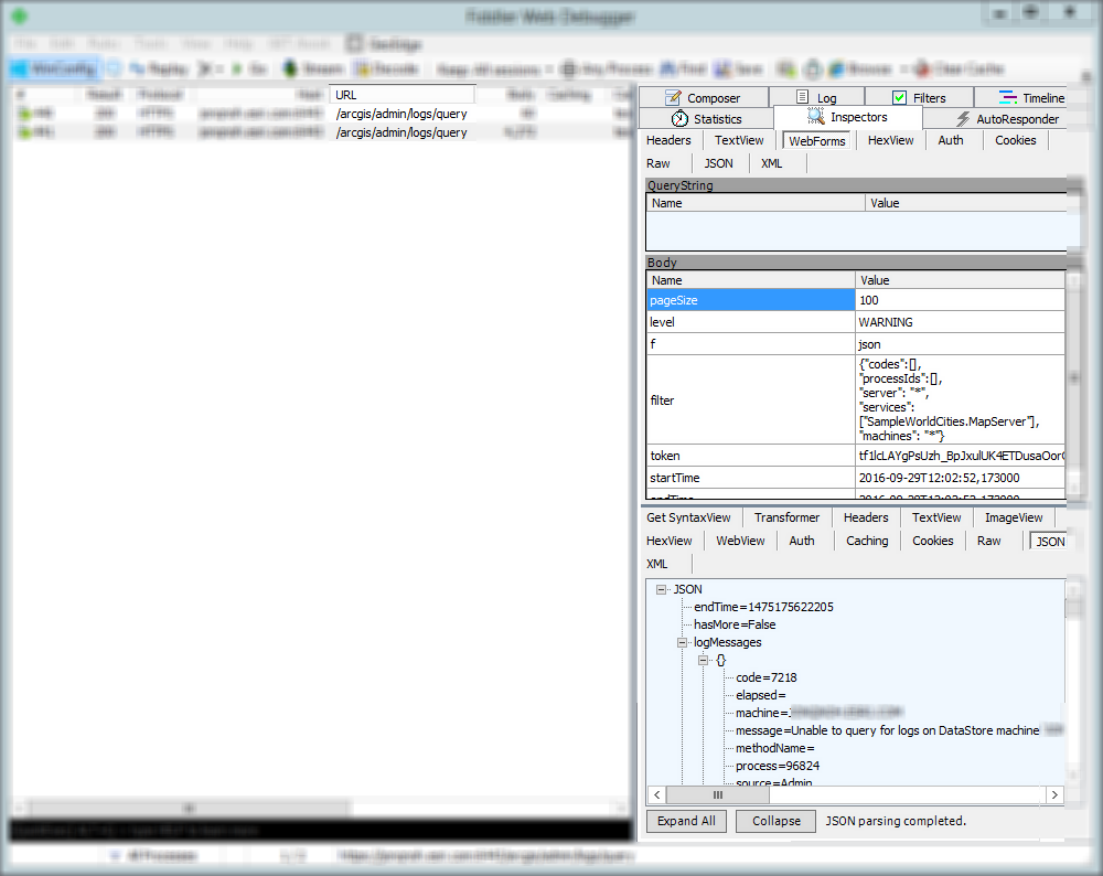

{"hasMore":false,"startTime":0,"endTime":0,"logMessages":[]}<SPAN class="line-numbers-rows"><SPAN></SPAN></SPAN>But if I query the logs directly, I get the errors that I expect to see:
{ "hasMore": true, "startTime": 1475158749762, "endTime": 1472583010032, "logMessages": [ { "type": "SEVERE", "message": "Unable to process request. json", "time": 1475158749762, "source": "Rest", "machine": "SERVER001", "user": "", "code": 9003, "elapsed": "", "process": "26244", "thread": "39", "methodName": "" },
