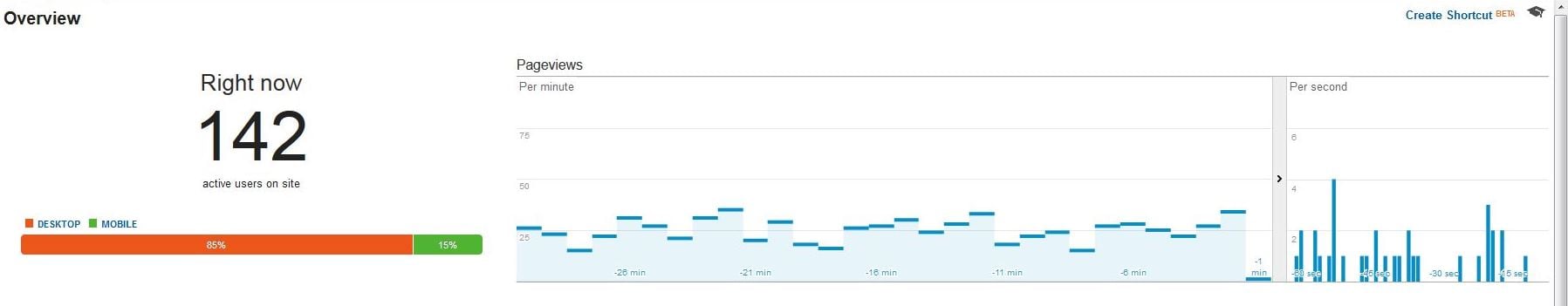

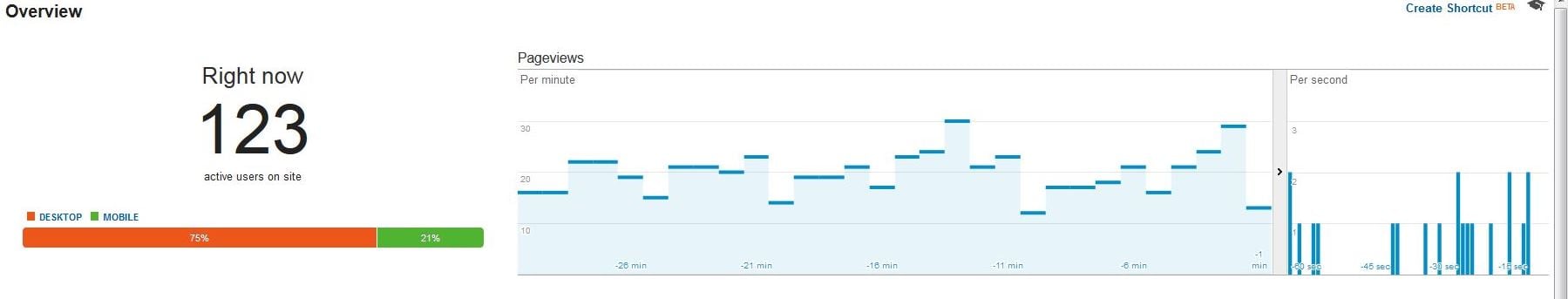

Below are a couple of screenshots from Google Analytics real-time view during our most recent events:
Based on this, I created a test with a thread of 40 users, a ramp up period of 20 seconds, and a loop count of 3. Does this sound reasonable, given the real-world examples shown above? Am I on the right track of way off?
