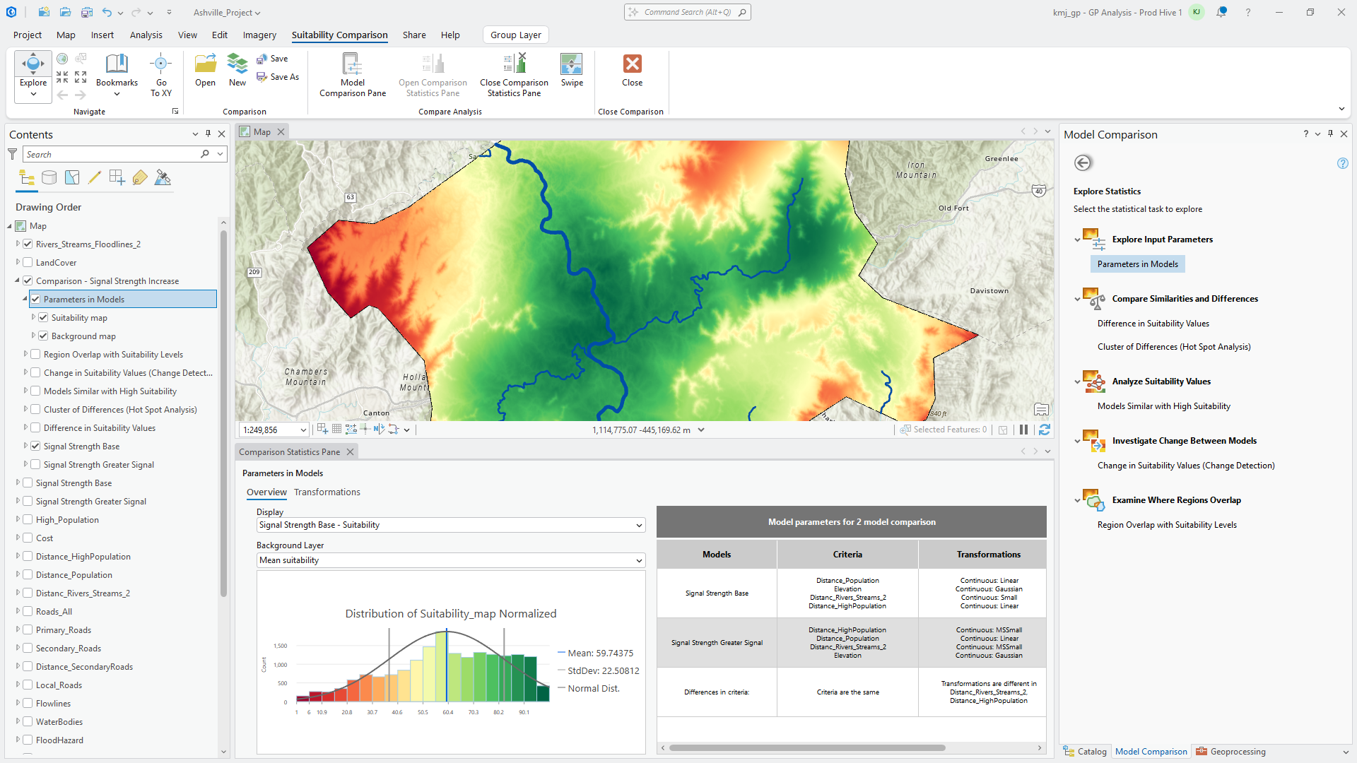

Caption: The Explore pane (right) with the Comparison Statistics Pane (lower middle) are displayed showing the Parameters in Models statistic. The suitability map for the first model is shown.
The first statistic, Parameters in Models (if selected), is displayed automatically. The Comparison Statistics Pane appears showing the parameters and a plot from the statistic. By default, the suitability map for the first model is also displayed.

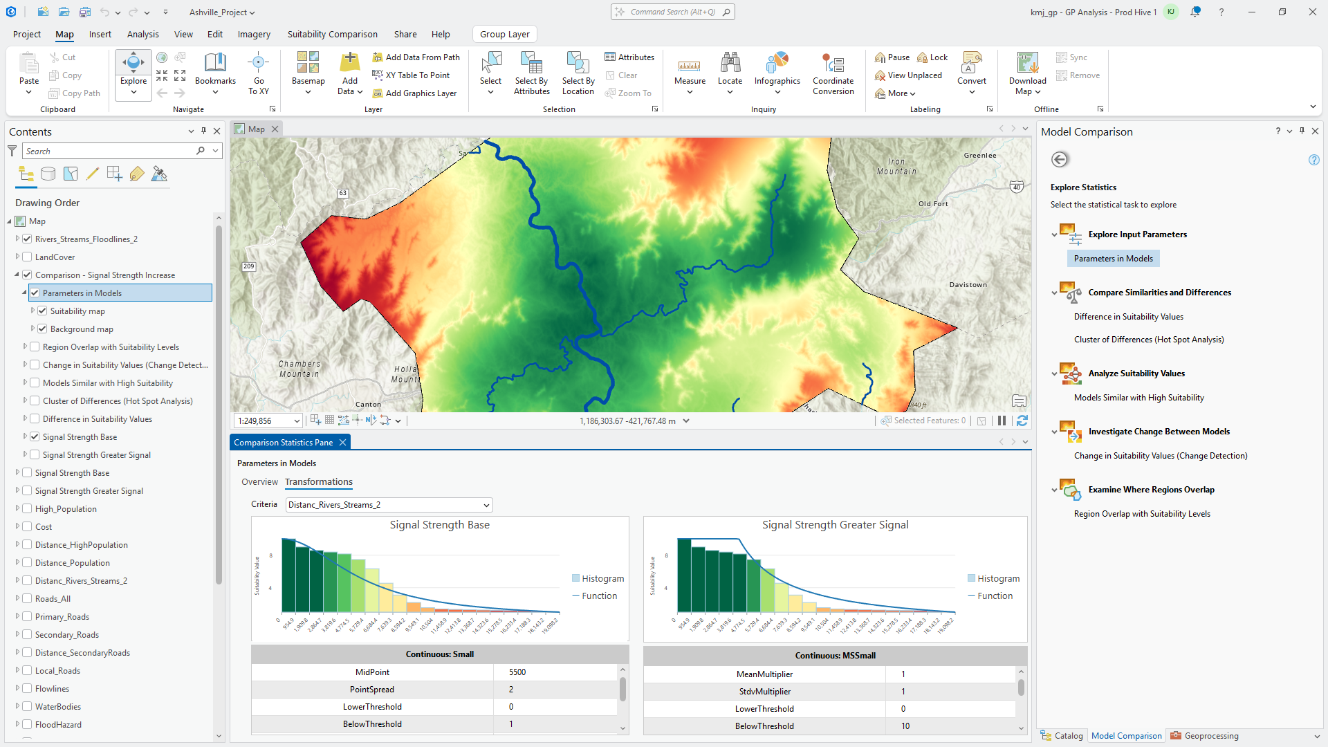

Caption: The Transformation tab in the Comparison Statistics Pane is displayed in the lower middle. The left plot shows the transformation function that was applied to basic signal and the right the more powerful siren.
Clicking the Transformation tab reveals the various transformations applied to the siren signal strength criteria. The left plot displays the standard siren transformation function (represented by the blue line), while the right plot shows the transformation function for the stronger signal. Notably, the standard siren signal transformation function tapers off more quickly, and the audible range is not as far.

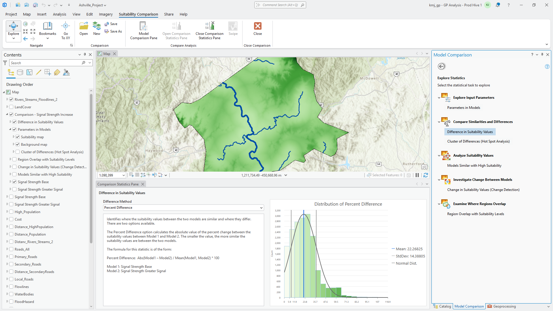

Caption: The percent difference in suitability values between the two scenarios.
Around the rivers and populated areas, the two models agree which is represented by the lighter green.

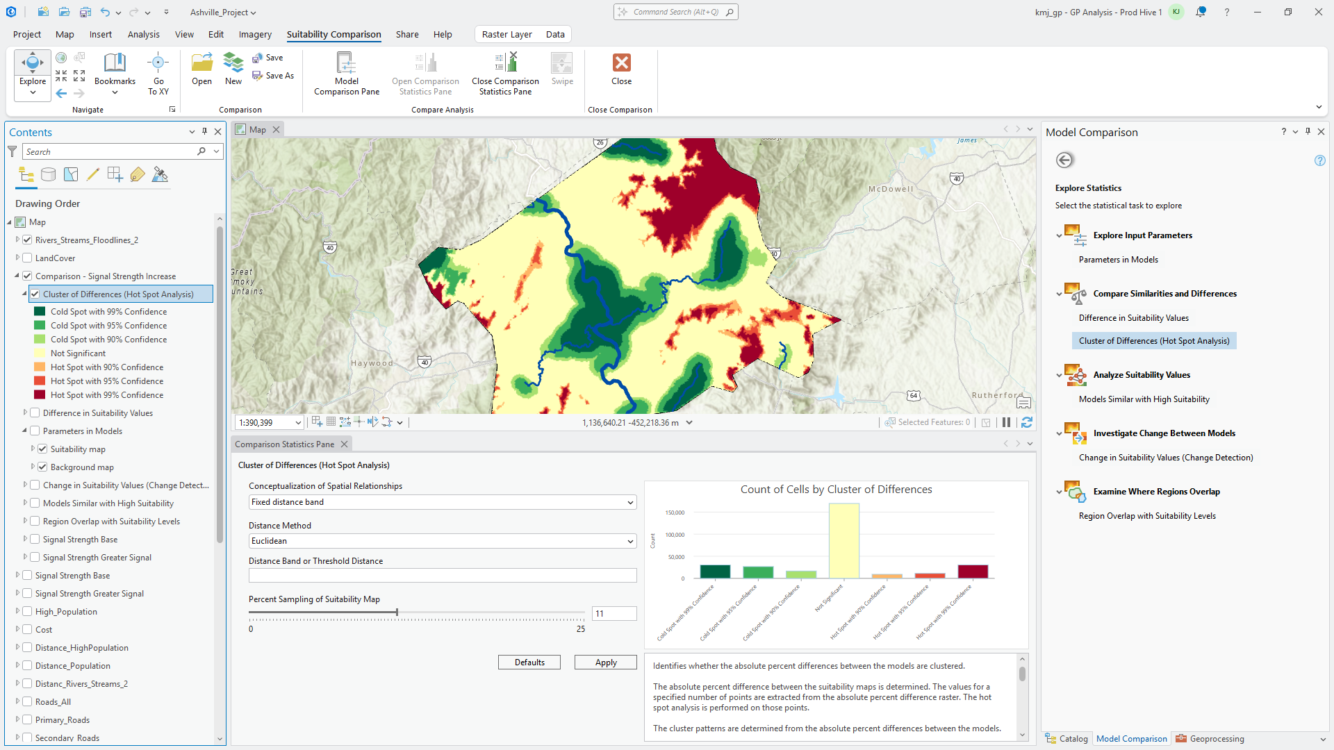

Caption: A hot spot analysis between the two scenarios.
The hot spot analysis highlights areas where the absolute percent difference between suitability values cluster. The green areas are where the models agree and the red areas where they differ. Notably, the models agree in regions with higher population density, particularly around the intersection of the two rivers.

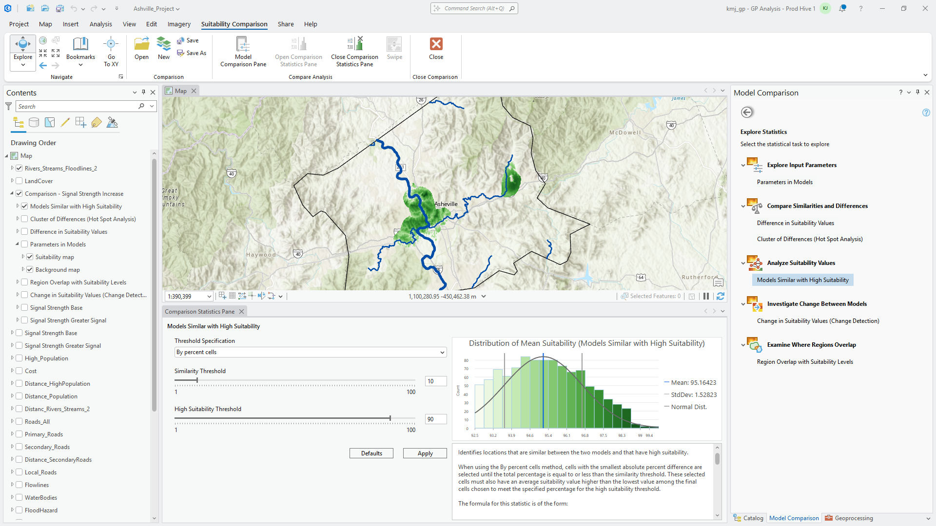

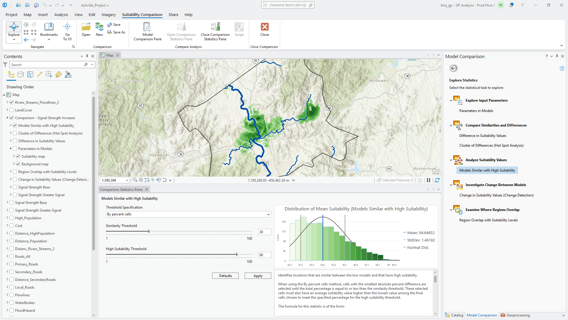

We can also look a little deeper by moving the Similarity slider to see where additional locations will be added as we increase the similarity threshold.
Caption: Increase the similarity threshold to include locations within the top 30 percent that are most similar, while also ensuring high suitability by focusing on locations within the top 90 percent of the highest average suitability values.
Notice additional locations are added away from the intersection of the two rivers uncovering other similar and highly suitable locations.

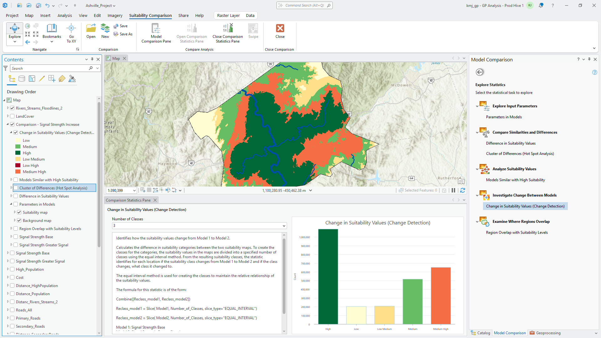

But how do the values change from one model to the other?
Caption: Applying the Change Detection statistic.
The dark green areas indicate regions where both models have high suitability. Notice that at the edges of these dark green areas, the orange regions represent a transition from medium to high suitability. This shift is attributed to the extended range of the more powerful sirens.

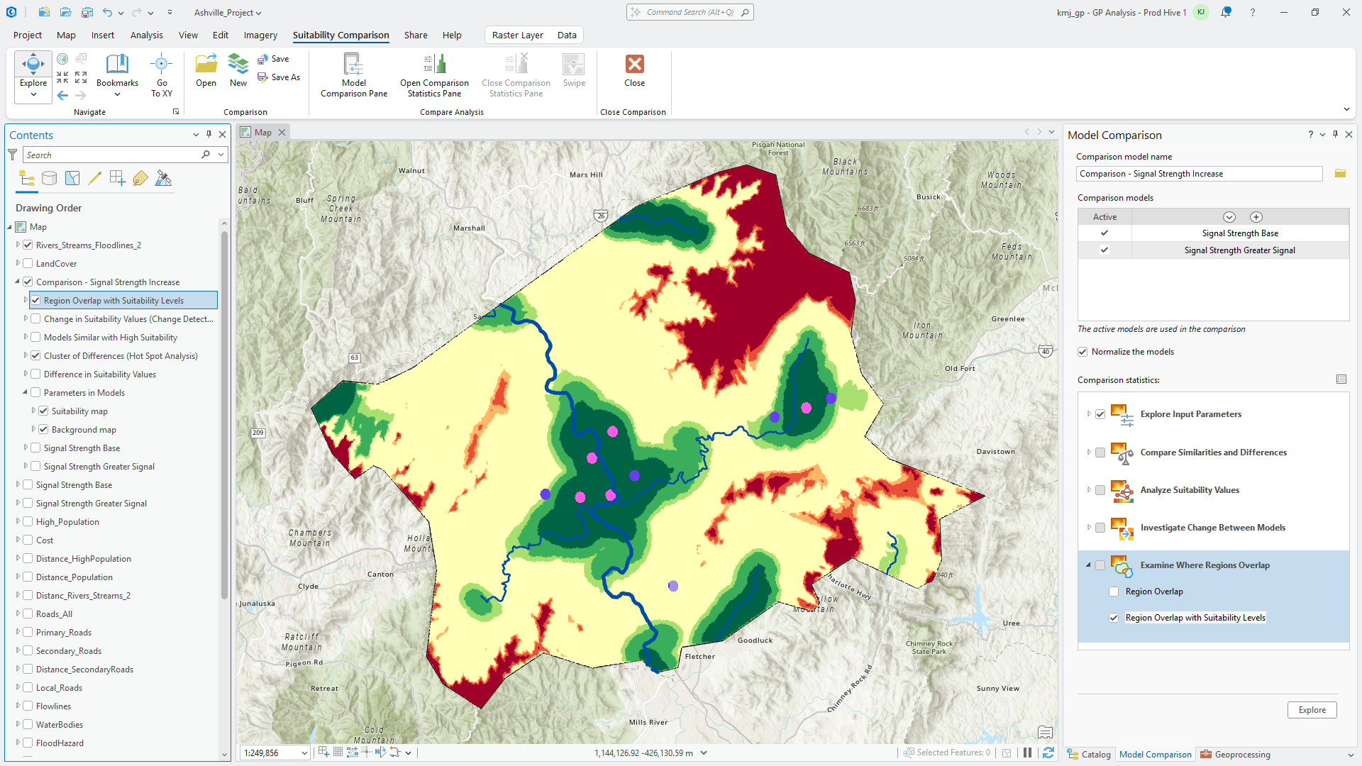

Finally, let’s examine the overlapping regions between the two models. The top five locations have been identified from the suitability maps.
Caption: The final locations for the standard and stronger sirens.
There is no overlap between the regions. The pinkish areas indicate the locations of standard signal sirens, which are concentrated around the populated areas at the river’s intersection due to their limited range. In contrast, the blue areas represent the locations of stronger signal sirens, which are distributed more widely along the flood zone, closer to other populated regions.
