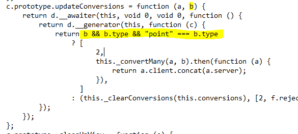

In the actual code it seems the properties are reversed:
it's actually looking for updateConversions(conversions, location)
in typescript the workaround I'm applying is:
Then it works fine.
