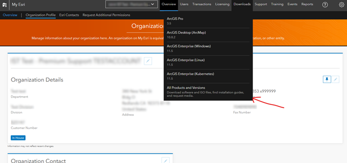

In My Esri, you will go to the Downloads tab and select “All Products and Versions.”

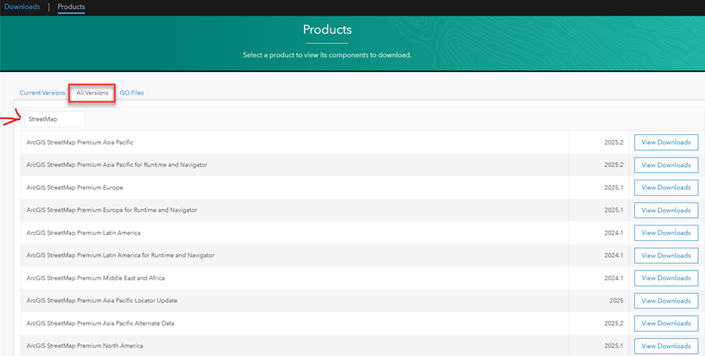

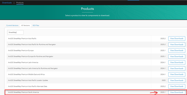

On the list of products, select the “All Versions” tab and search for StreetMap in the Quick Search Box
From here, you will select the appropriate geography and download the files. For instance, to select and download the data for North America, you will start by viewing the downloads for the region of interest. Depending on the products purchased by your organization you may see several options for StreetMap Premium data and would need to search through the list for your region of interest.

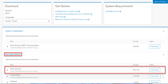

On the download page, you will download the data specific to the region from the Data and Content section of the download page. The data will be delivered as a mobile map package (MMPK):

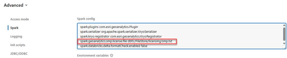

Once the file is saved in an accessible location, you can edit the configuration for the computing cluster where you will be using the SMP data so that the Spark config includes a line to reference the license file. Below is an example of the additional config line referencing the smp.txt file shown above. Update to reference the location of your file. Note that if you are using DBFS, you will need to reference it using “dbfs:/FileStore/…” instead of “dbfs/FileStore/…”
spark.geoanalytics.smp.license.file dbfs:/FileStore/licensing/smp.txt
When you start your computing cluster and reference StreetMap Premium data for your locator or network dataset, the license should then be recognized.
