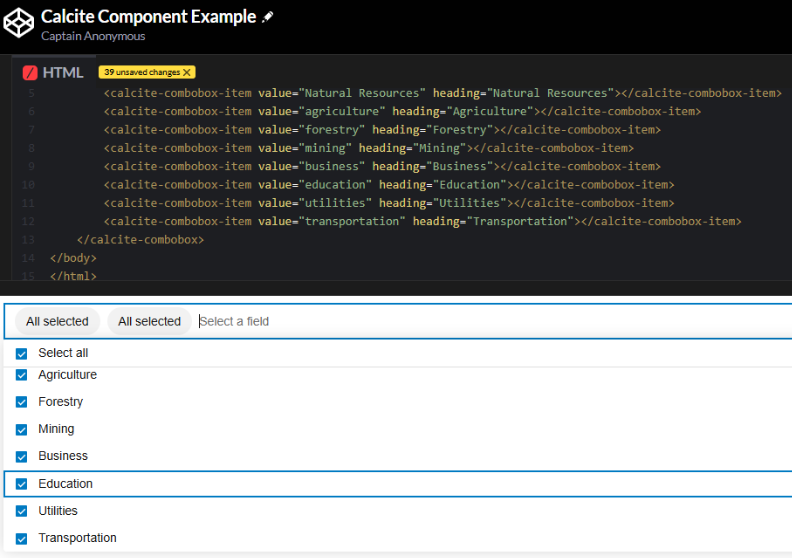

When after that checking the very last unchecked value, the combobox shows the “All-Selected”-Chip instead.

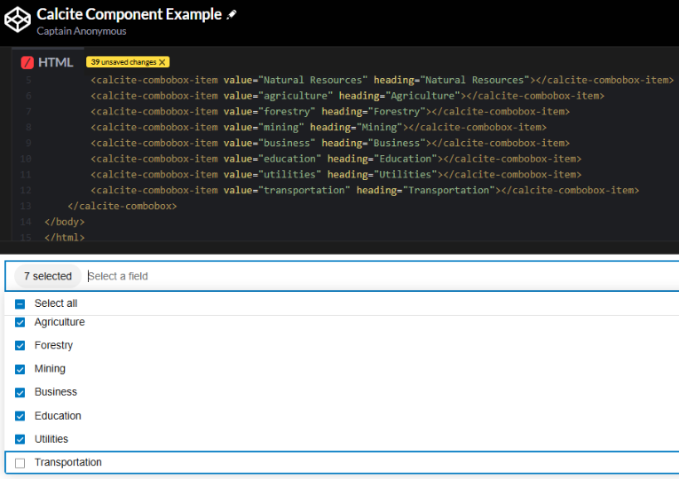

When after that unchecking the last checked value one expects to receive the initial view where the combobox showed the some values and the Plus-N-Chip. Instead the combobox now shows only the N-Elements-Chip. It looks as the combobox would switch its mode from “fit” to “single”.

Selection of all items |  |
After unchecking the last item |  |
