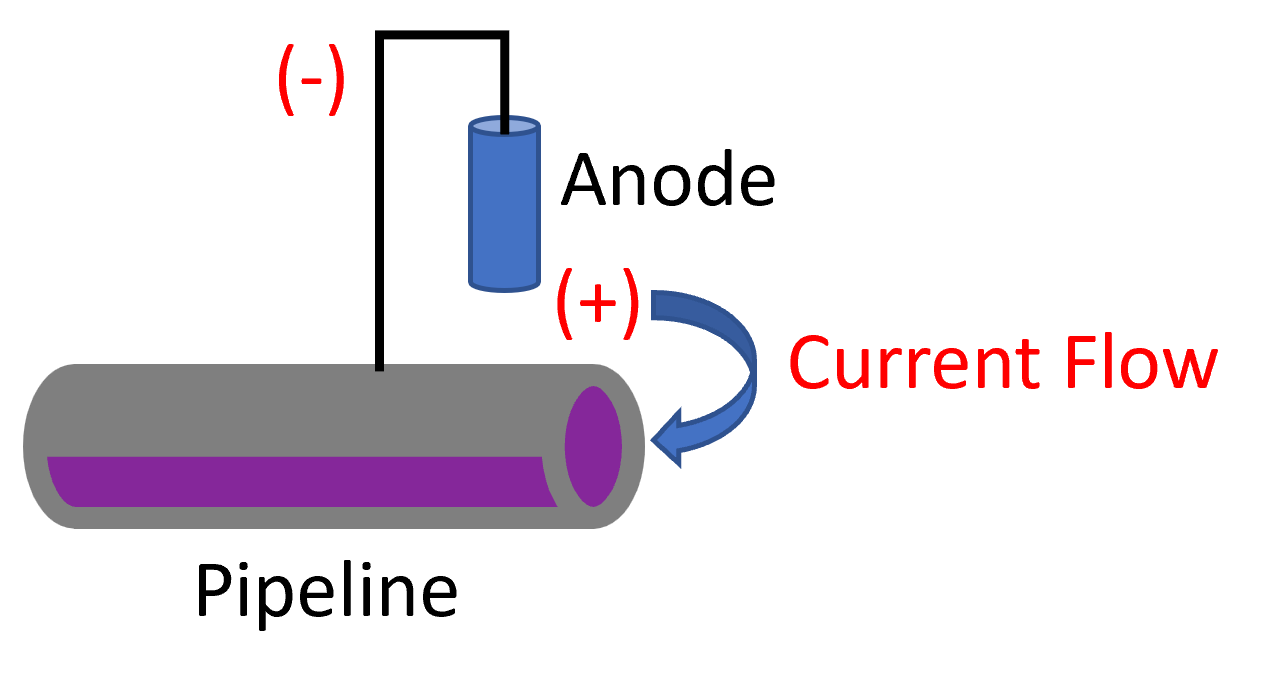

Galvanically Protected Pipe
We Need a Sacrifice
A galvanically-protected CP system is also called a passive-cathodic protection system. It is passive in that no external electrical energy is required. Galvanic protection works by connecting a more electrochemically active metal to the system than the pipe system which is being protected. This electrochemically active metal is simply a hunk of metal buried in the ground near the pipe system. This component is called an anode. Common anode materials include zinc, aluminum, and magnesium. In a galvanic protection system, the anode gives up electrons to the pipe system. This sacrifice of electrons results in the anode corroding rather than the pipe system.

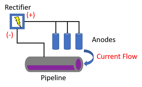

Impressed Current Cathodic Protection
Charge It
Impressed-current CP systems are typically used to protect large pipe systems such as transmission pipelines. The rectifier inserts direct current (DC) voltage into the CP system. A rectifier is a device, where AC electricity typically provided by the local electric utility system, is transformed into direct current. A cable connects the rectifier negative terminal to the pipe system. A rectifier cable connects the rectifier’s positive terminal to the anodes within the anode bed.

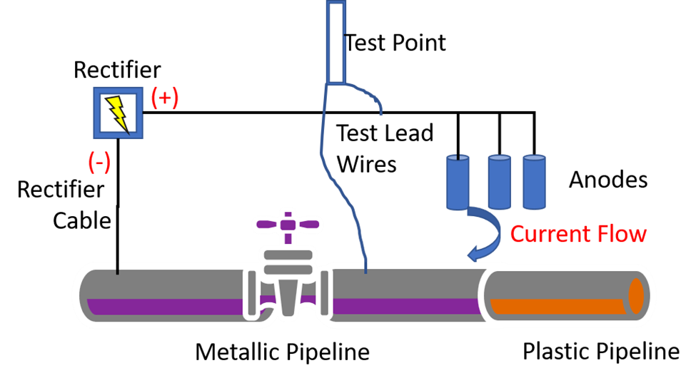

Material Type Matters
The materials used for pipe system components are critical to a CP system. Some materials such as polyethylene (Plastic PE) are non-conducting and act as insulators. These insulating materials break the electric circuit.
Cathodic Protection System with Insulating Plastic Pipe

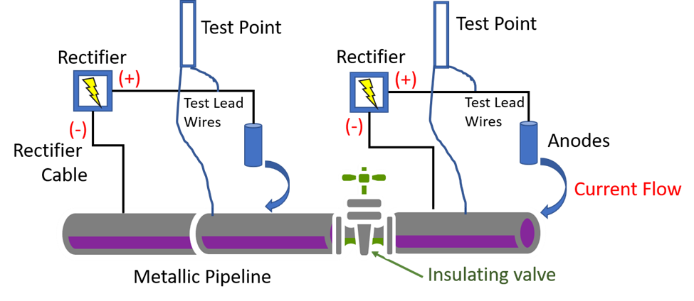

In addition to plastic pipes and plastic components that act as insulators and break the electric circuit, metallic components can be manufactured so that they too can serve as insulating devices or junctions.
Cathodic Protection Systems Separated by an Insulating Valve

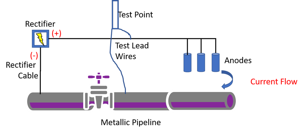

Management of the CP components in a Geodatabase is not difficult. The anodes, rectifiers, test points, decouplers, and grounding points are modeled as point features. The test lead wires, bonding lines, linear anodes, AC mitigation wires, and rectifier cables are modeled as line features. Esri’s Utility and Pipeline Data Model (UPDM) provides a template data model for managing these CP components.
Where data management of the CP systems has historically become challenging is the definition and maintenance of the CP zone. Some organizations will also refer to this as the cathodic protection circuit. The CP zone is comprised of the pipeline, pipe devices, pipe junctions, CP devices, and CP lines, which together form an electric circuit.

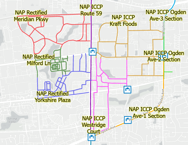

Here too UPDM provides a template configuration to simplify. Built into UPDM is a Utility Network configuration for modeling CP zones as subnetworks. This allows the circuit’s extent to be automatically generated and maintained by ArcGIS’s Utility Network capabilities.
Cathodic Protection Zones
