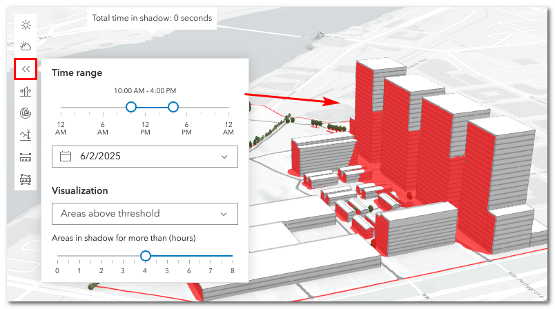

In our use case, we visually nest our widgets into Expand widgets. The user clicks on an Expand button to activate a certain 3D tool:
In the example of the ShadowCast widget shown in the screenshot above, this makes sure that the red shadow is displayed / casted only when the widget is launched by the user. Also, the user can resume to the previous widget state. Another advantage is, that the performance of the scene doesn’t degrade as the user can selectively start a certain widget.
