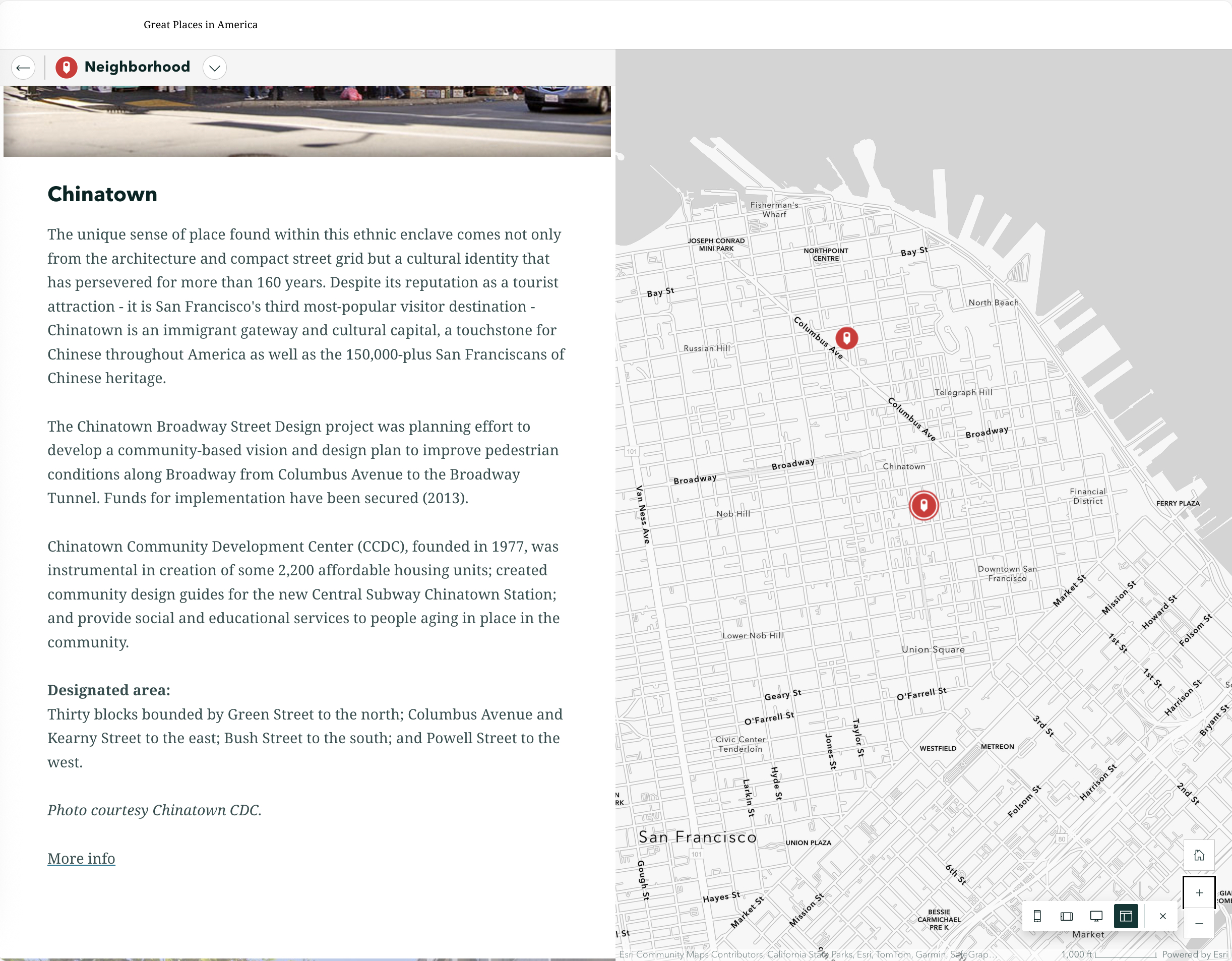

Here's a screenshot of a more robust concatenated description in a map tour. You can view this feature layer and inspect the "Full description" field to see the field information needed for this description:
Great Places Shortlist layer - Data.
