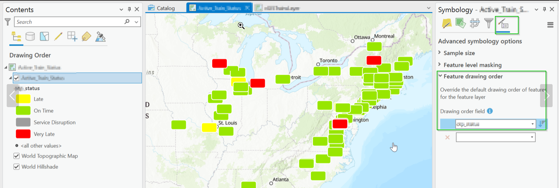

https://pro.arcgis.com/en/pro-app/latest/help/mapping/layer-properties/set-the-feature-drawing-order.htm
in the pic above, it is sorting the drawing order alphabetically.
we'd have to assign a rank/score to each status per record, so it can draw the layer accordingly.
unfortunately, it is only supported within pro, not as web feature layers.
when publishing, we get this warning:
20027: Layer uses advanced renderer settings
Advanced settings are not supported

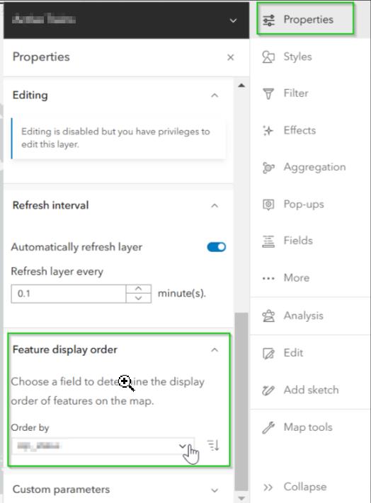

So, although the layer draw order is not supported directly by the web feature layer, the draw order is able to be applied to the operational layer within a web map.
this setting is controlled directly in the web map by the 'Feature Display Order' property:
https://enterprise.arcgis.com/en/portal/11.2/use/set-feature-display-order.htm
