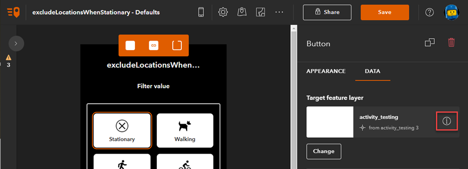

- In the QuickCapture web designer, select a project button and navigate to the DATA tab.
- Click the (i) icon to open the item page for the feature layer the button is sending features to.

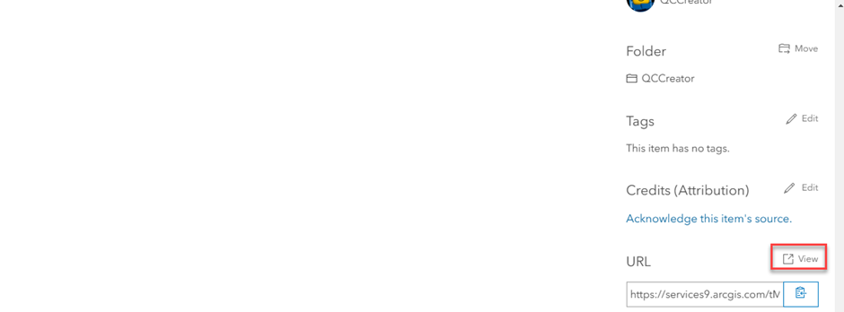

- Scroll down to the URL section for the feature layer and click the View button.

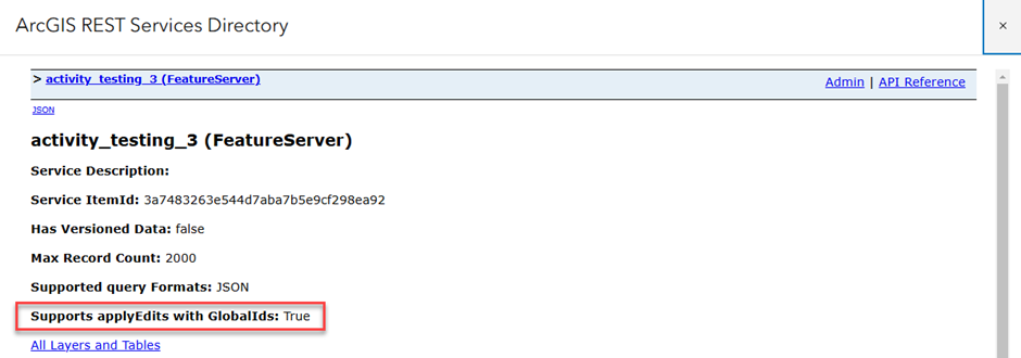

- This will open the ArcGIS REST Services Directory page for the feature service. Look for the SupportsApplyEditsWithGlobalIds property and ensure it is set to True.

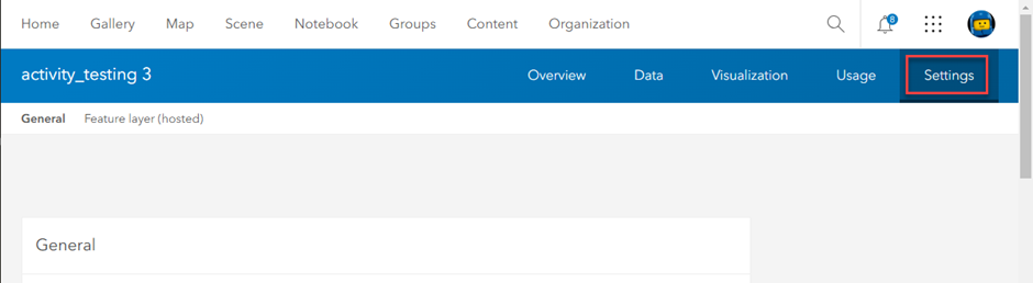

- If the property is not set to true, go back to the feature layer’s item page and click the Settings tab.

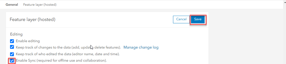

- Scroll to the Editing section, check the Enable Sync option, and save the change. This will create the required fields and indexes, and set SupportsApplyEditsWithGlobalIds = true.
- Note: This is a one-way process; you can uncheck Enable Sync later if it is not necessary for your workflows.
