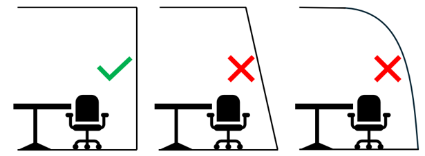

Regarding the architecture being scanned, walls must be vertical. The ArcGIS Pro tool that generates the floor plan will not work for walls that lack a vertical cross-section, such as slanted or arched walls.
Figure 1. Cross-section profiles of walls that are vertical, slanted, or arched. Walls must be vertical
for the scanned data to work with the ArcGIS Pro tools mentioned later in this article.

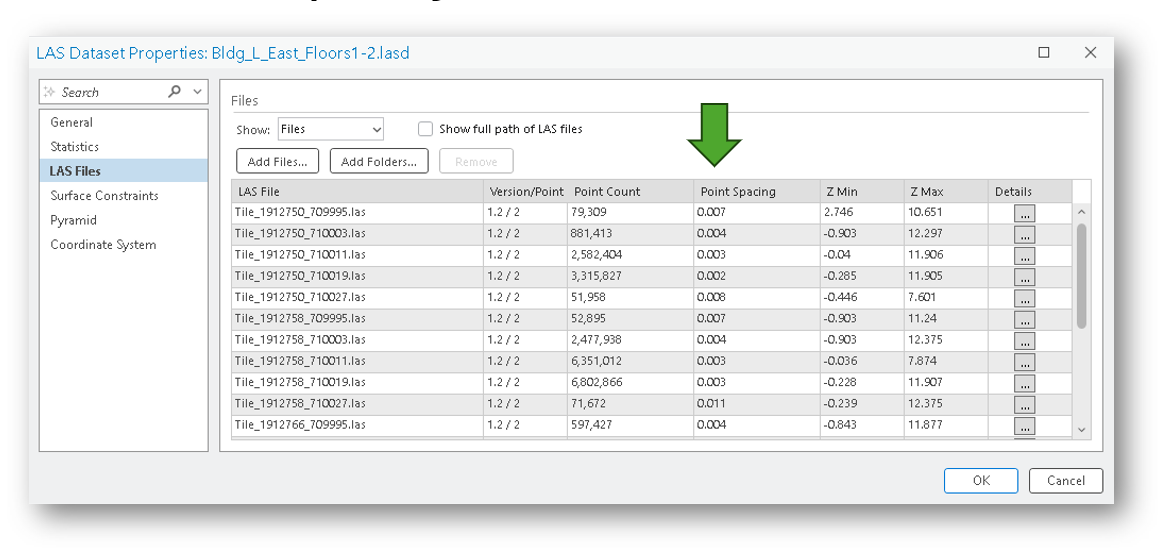

2. Point spacing—The points collected by the device should have an average point spacing of 0.2 inches (5 millimeters) or smaller. Point clouds with larger average point spacings can still be used but the generated floor plans may have more gaps and artifacts. Point spacing is determined by multiple factors including the number of sensors on the device, the distance from the device to the surface being scanned, and scan time. You can do a test scan and use ArcGIS Pro to calculate statistics including average point spacing.
Figure 2. ArcGIS Pro dialog showing Point Spacing values (in meters) for individual LAS files in
a LAS dataset. The average point spacing for the larger LAS files (those with millions of points)
is around 3 millimeters.

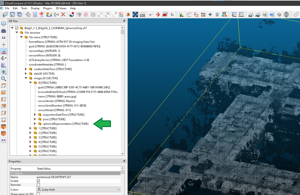

There are tools available to investigate the information in point cloud data files (including LAS). For example, CloudCompare is a free software that can open many common point cloud export file formats (including E57, PTX, PLY, and OBJ) and display detailed information about their contents in a tree view.
Figure 3. Viewing an E57 file in CloudCompare, with a tree view of the file contents at top-left.
This particular E57 has panoramic (“spherical”) images, as indicated by the arrow.

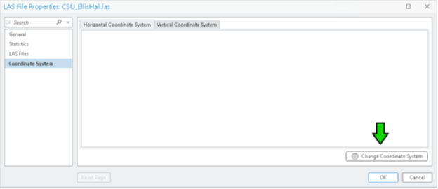

- Try applying a projected coordinate system that is well-suited for the geographic location of the facility, then check whether the point cloud is correctly positioned when added to a map. For example, a facility in Fort Collins, Colorado USA might use State Plane Colorado North, or maybe UTM Zone 13 North. When you view the properties of a LAS file in ArcGIS Pro, you can use the Coordinate System tab to view and change the CS before adding the LAS file to a map to check whether the data appears (possibly as a red box) in the expected geographic location.
Figure 4. You can use the Change Coordinate System
button to assign a coordinate system to a LAS file.

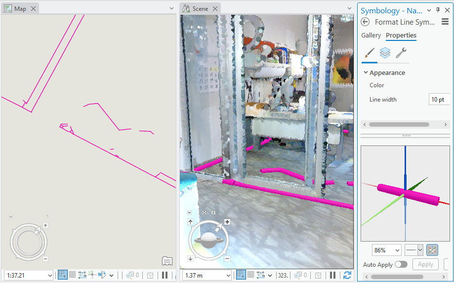

- It’s easier to edit the polylines in a Map, but the point cloud can be an important visual reference to differentiate walls from furniture, shadows from doorways, and so on. A couple tips:
- You can place the Map and Scene side-by-side, then use view linking to sync up navigation.
- To visualize the polylines in the scene, you can set the polyline layer’s symbology to a 3D tube with a large enough size so that the tube edges poke out beyond the point cloud in the scene.
Figure 7. Linked map and scene views. In the scene, the polyline layer is symbolized
with a thick 3D tube to make it visible in the point cloud.
