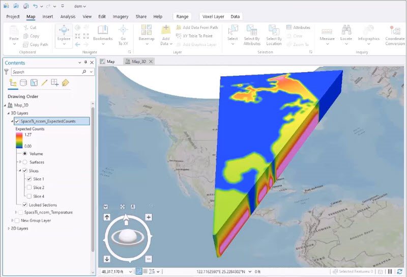

The Space Time Kernel Density tool can now create an output voxel layer. This output represents the density of the input points as magnitude per-unit-area across multidimensional space and time. What does that mean? You can now interactively explore the results as a 3D volumetric visualization!
Have a look at the following screenshot for an example of what you can do with this new capability.
The output must be a netCDF raster, which you create by specifying ".nc" as the filename extension for the Output Raster parameter. Some new Usages help guide you through the process of creating the voxel layer and adding it to a scene.

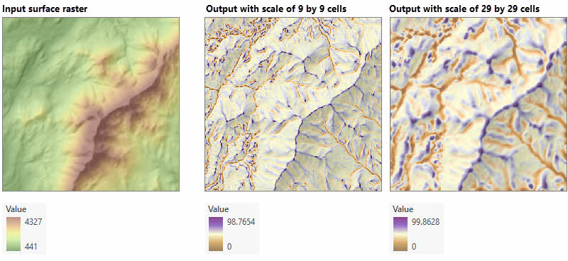

Multiscale Surface Difference and Multiscale Surface Percentile
Two new tools identify specific landscape characteristics of a surface raster at multiple scales. In this context, different scales represent different neighborhood distances from each input cell.
The Multiscale Surface Difference tool identifies the maximum difference from the mean for each input cell across multiple scales. The Multiscale Surface Percentile tool identifies for each input cell the most extreme percentile value.
For both tools, an optional output raster identifies the specific scale where that value occurred. You can also control how the increase in neighborhood distance behaves with parameters for the minimum and maximum values, as well as the increment between the scales.
The following illustration shows the result of applying two different scale settings to a surface raster with the Multiscale Surface Percentile tool.

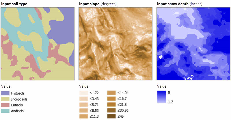

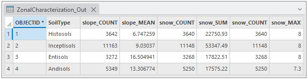

The new Zonal Characterization tool summarizes the values of multiple input rasters for a zone input. Its primary output is a table where each record represents an input zone, and each field the is the value of the specified statistic for all the cells that fall within that zone.
While this tool supports the same types of statistics as the Zonal Statistics as Table tool, it offers several advantages. In one run of the tool, it can calculate several different statistics for the same value raster, the same statistic for multiple value rasters, or any combination thereof. You can also choose to create a new output feature class that joins the output table to the input zone data.
For example, say you have a workflow for water level conservation where you want to know the average slope, the total accumulation of snow, and the maximum snow depth for a soil type map. The images below show the inputs for the tool followed by the resulting output table.
The output table:
