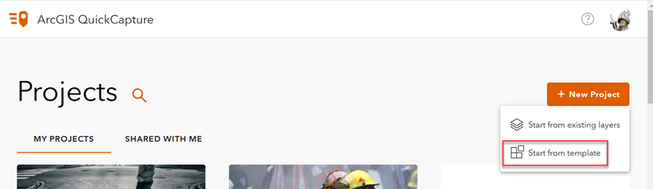

1. In the QuickCapture Web Designer, choose Create a New Project.
2. Select the option Start from template.

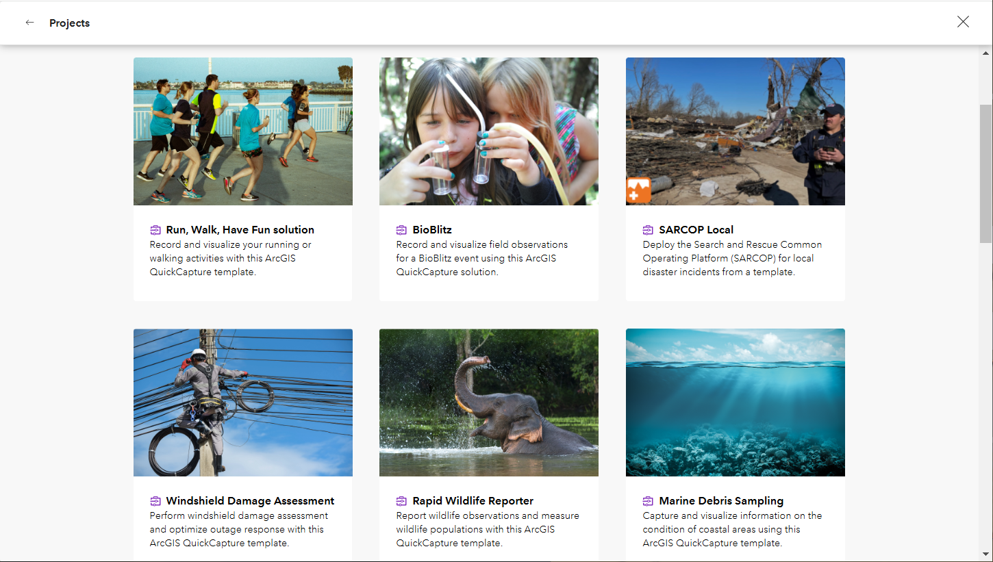

3. Browse through the available templates. Clicking on any template will display more details before you proceed with deployment.

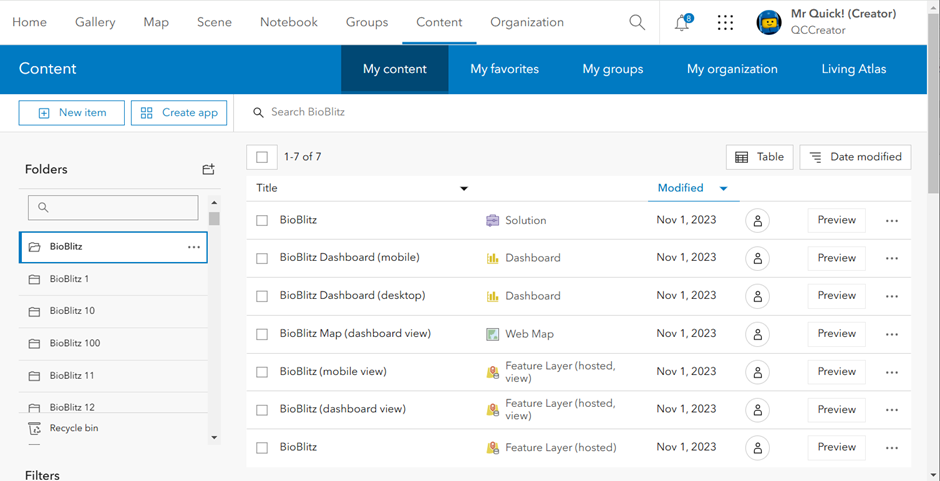

- Once you deploy a solution-based template, a new directory will be created in your content. This directory will include all the related items (QuickCapture project, layers, web maps, and dashboards).
- The directory name will be based on the original template (e.g., `TemplateName`)
- If you deploy the same template multiple times, the folder name will be incremented (e.g., `TemplateName_2`, `TemplateName_3`, etc.).
- On completion, you can open the deployed project in the QuickCapture web designer, edit it, and share it with mobile users (ready for capturing data in the field).

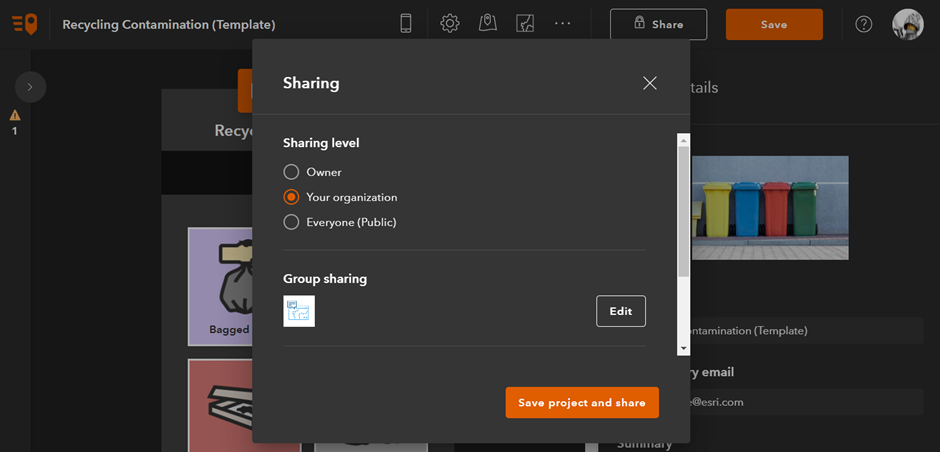

- Create a group in ArcGIS Online or ArcGIS Enterprise (e.g., "QuickCapture Templates").
- Share your project and layers with this group.
- Ensure the project and layers are shared with your organization so everyone has access to them.

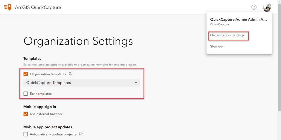

- As an Administrator, log in to the QuickCapture Web Designer.
- Go to Organization Settings and under the Templates section, select the group you created from the drop-down list.
- You can choose to uncheck the option to include Esri templates, so only your organization’s custom templates are available.

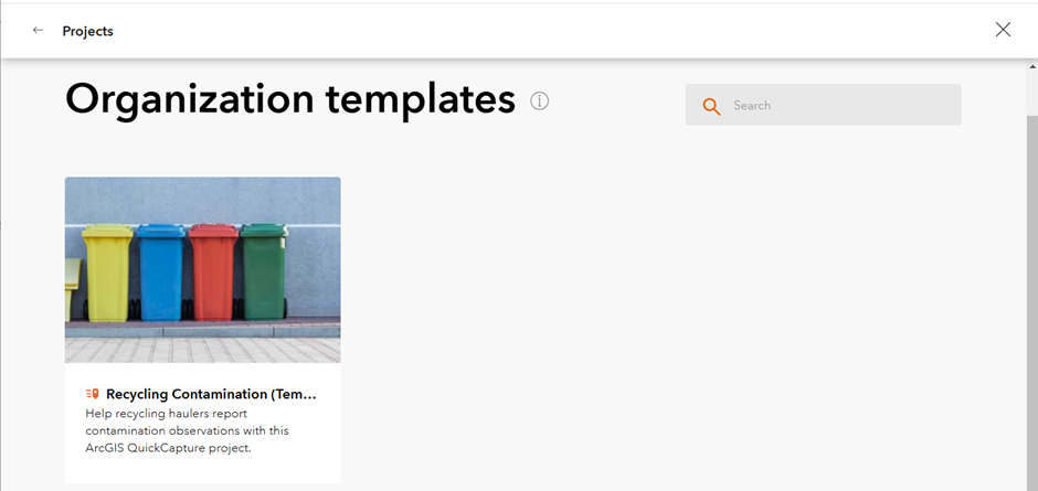

Deployment Process:
- When users create a project from a template, they will be able to select any of the projects shared with the group.
- Upon deployment, the project and layers (and views, if applicable) will be created as new items in the user’s content.
