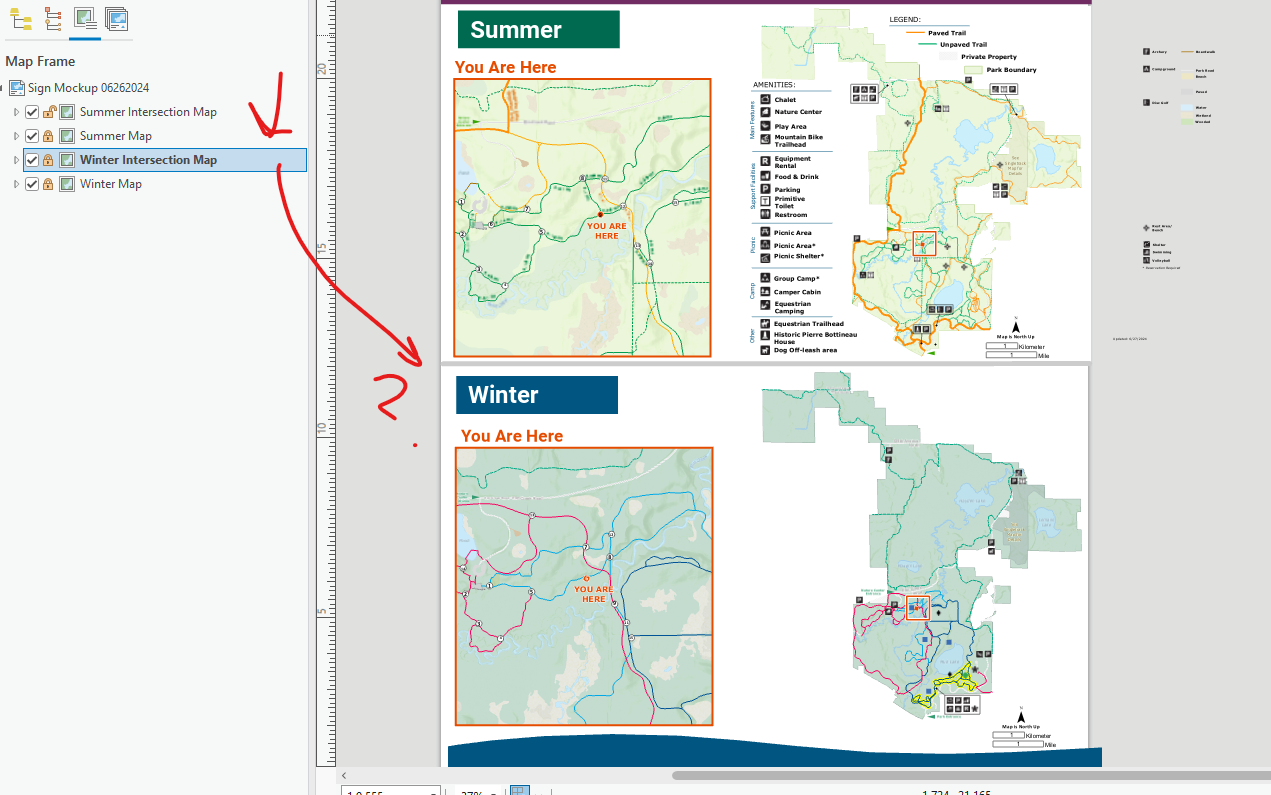

Layout Element Boundary When Locked:
When an element in the is locked and selected in the TOC there is no visual indicator as to where it is within the layout. When locked, please show the element boundary. Vice versa, the ability to still select a locked element in the layout and see it hightlighted in the TOC.
Example with locked map frame below (would like this for all element types):

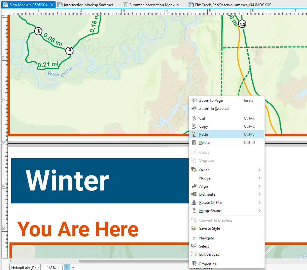

Right-click Paste to a specific spot:
When pasting content from one Pro layout to another, it would be helpful to be able to control the location to where the paste applies. Currently when pasting, the content only shows up in the location of the prior layout. Please add a way to paste to a specific spot.
