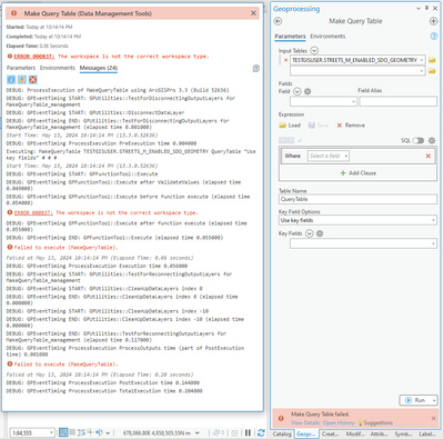

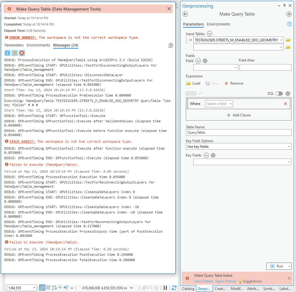

So, it is a very handy tool, but it doesn't support enterprise database tables (non-GDB).
Make Query Table (Data Management)
This tool accepts data from a geodatabase or an OLE DB connection.
ERROR 000837: The workspace is not the correct workspace type.
Idea:
Could Make Query Table be enhanced so that it supports database tables (non-GDB)?
