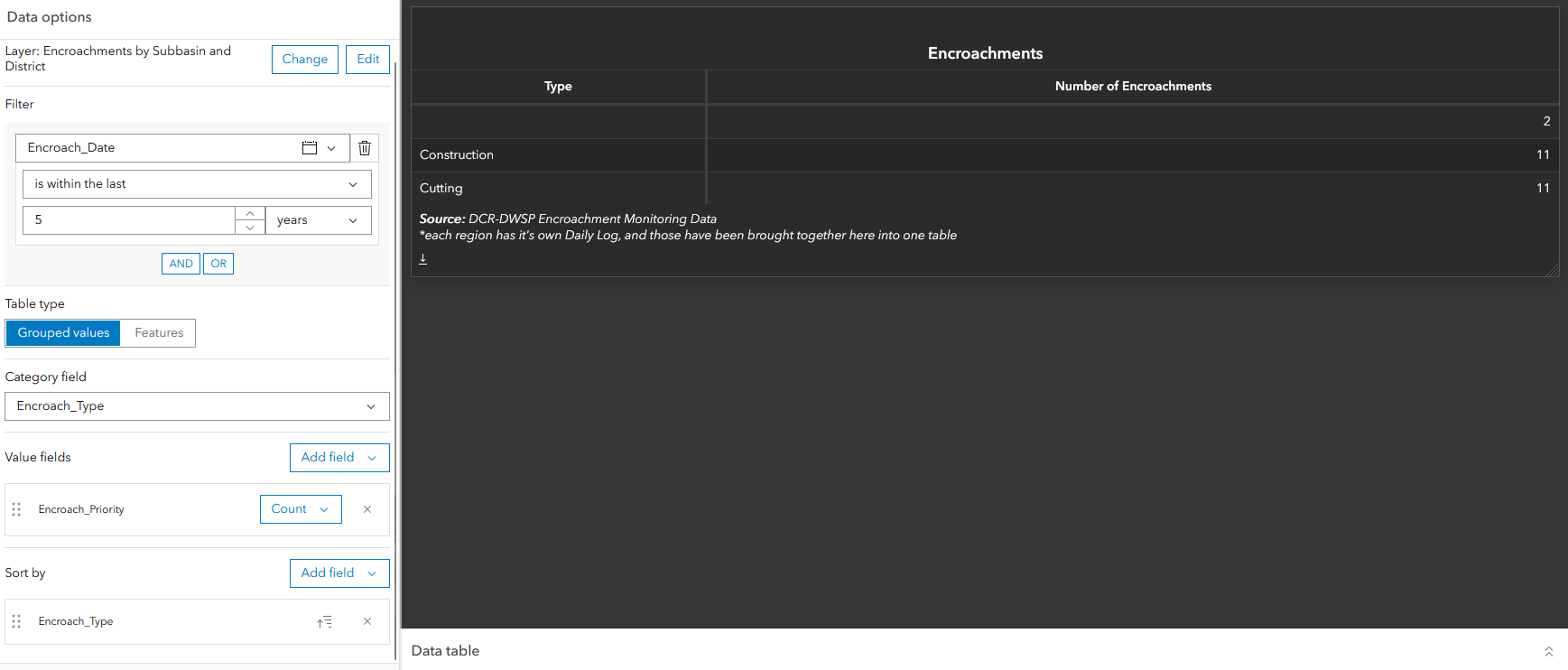

Here are the settings used within the Table Element when download summarized data is an option for me to toggle under "General":

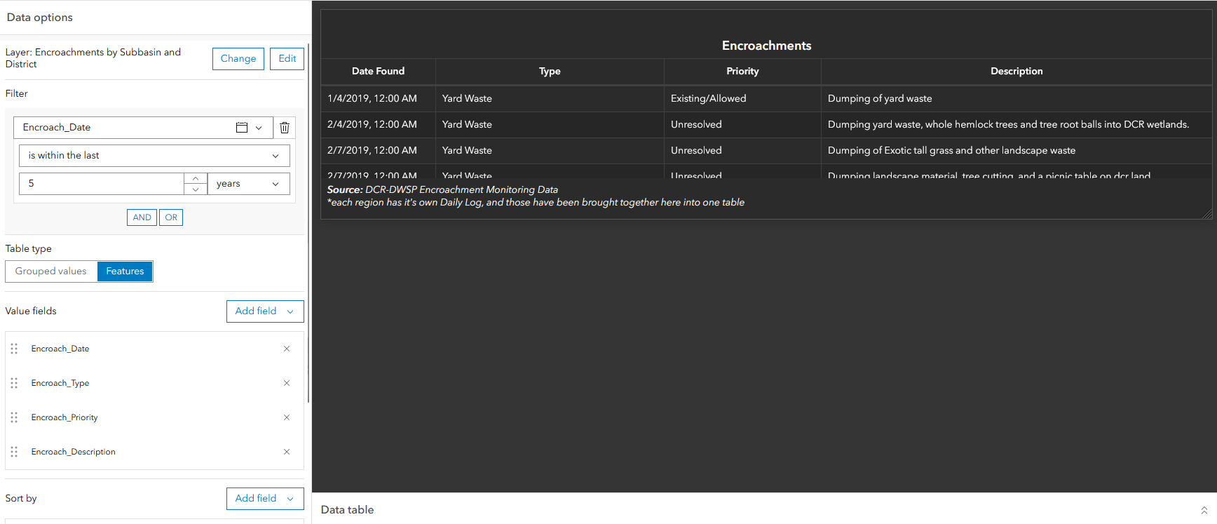

Here are the settings used with a different Table Element when download summarized data is not an option for me to toggle under "General":
Some additional details:
I am working in ArcGIS Online and using a data expression to bring two different feature layers together into a new FeatureSet. I need to provide information on individual records, so I can not use Table Type = Grouped Values. Both feature layers referenced in the data expression allow export/download (that was the first thing I checked).
