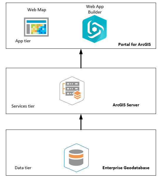

Let’s decompose this application in all subcomponents as shown in the figure 1:
Figure 1: Application subcomponents
To promote this application from Development to Production environment successfully, all sub-components (from all tiers) should be taken in account. If organization wants to automate this process, they need to automate for all tiers. Let’s go through all the implementation workflow:

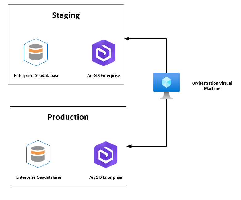

- Let’s consider a simple scenario to automate content promotion. The simple scenario is being shown in figure 2. Assume that our current deployment is 2 environments based i.e., Staging and Production.
Figure 2: Automated Content promotion scenario
- Both environments (staging and production) are completely isolated. There are only linked through Orchestration virtual box which should contain following installed components:
- ArcGIS Pro (or at least licensed ArcGIS Server) to have ArcPy, which is going to automate data promotion operations and pusblish non-hosted service.
- ArcGIS API for Python to automate all operations around app tier. Generally, API is also installed with ArcGIS Pro (ArcGIS Server), but latest version can also be installed using Conda.

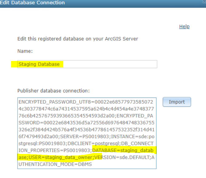

ArcGIS Servers should be configured in following way:
- Lowest environment: Configure ArcGIS Server with a database connection to corresponding to environment.
Staging database whose name is staging_database and it uses a database user staging_data_owner.
SD File is created from ArcGIS Pro which is using same data connection as above.

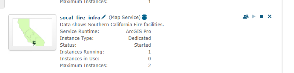

arcpy.server.UploadServiceDefinition(inSdFile, inServer)
ArcPy needs 2 input parameters one is ArcGIS Server connection file, and one is Service Definition which is created using ArcGIS Pro.

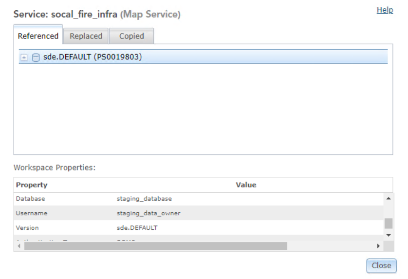

At the end it publishes service in staging environment in root folder for ArcGIS Server:
The service is published with referenced database:

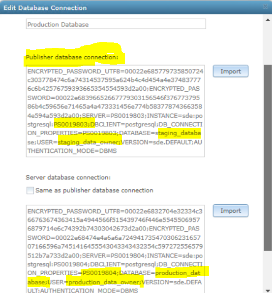

- Production Environment: Configure ArcGIS Server in a following way:
Publisher database connection should be configured with credentials of data owner from staging database. Server database connection should be configured with production data owner credentials.

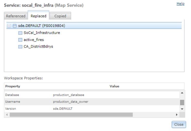

Now by executing same line of ArcPy based python code, the service is published in production environment. The service is published with replaced dataset, where staging credentials are being replaced by production:

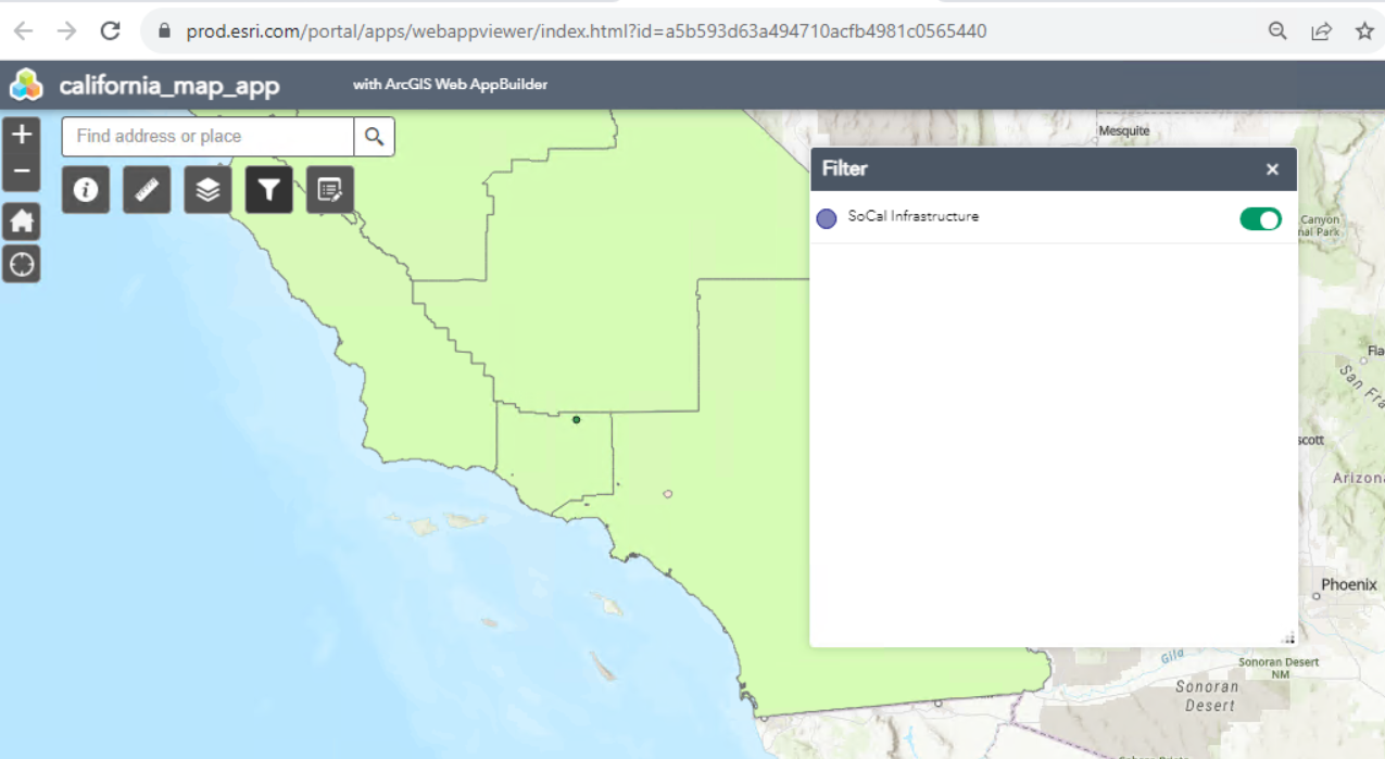

Congratulations, you have successfully promoted Web Mapping Application from staging to production using automation script and application is fully working with all widgets in production environment:
