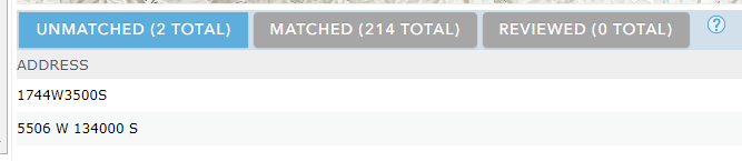

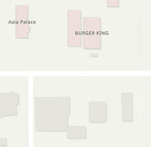

I've geocoded an excel worksheet in agol. Two of the addresses do not match. When I open the layer for review, I can easily see what the problems are:

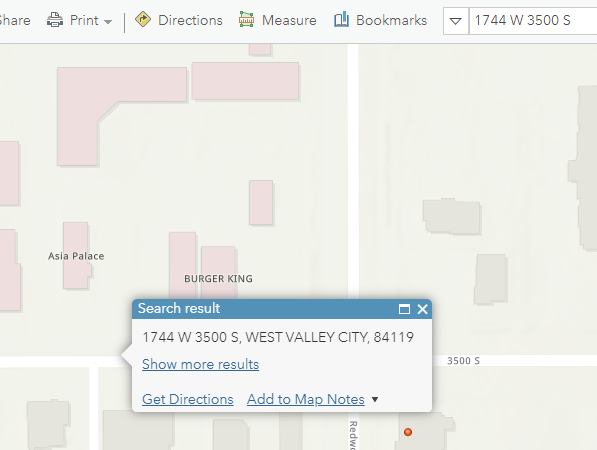

The first address should be 1744 W 3500 S and the second address should be 5506 W 13400 S. When I make the changes in the unmatched table, none of the suggestions are any good. I change the geocoder to the one my agency has online so as not to invoke the ESRI world locator and then enter the corrected addresses, one at a time in the Find address or place window and click search:
So far so good. I then click right next to the call out on the far left side to drop a point and select Match
And I get a matched icon. I then repeat the process again for the other unmatched address and select Done Reviewing.
But my previously matched addresses are now gone:
How do you actually rematch an address in AGOL and have the location stick?
