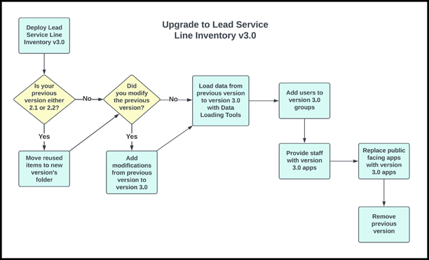

Version 3.0 Upgrade Process
We suggest this process to upgrade an existing Lead Service Line Inventory implementation to Version 3.0.
- Deploy version 3.0 of Lead Service Line Inventory to your ArcGIS organization
- Determine whether your existing deployment is in an out of the box state or has been modified post deployment
- If necessary, add your modifications from your previous deployment to version 3.0
- Load data from previous version to version 3.0
- Add users to appropriate groups for version 3.0 apps
- Provide version 3.0 apps to staff
- Update public facing apps to version 3.0 URLs
- Remove previous version
