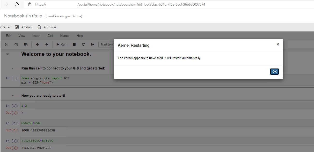

Notebooks looks fine, docker images are configured, the account was created, web adaptor configured etc.
It's possible use the basic stuff like addition, subtraction, division, printing messages, numpy etc.
But if I try to use the arcgis (GIS, ArcPy etc) elements the kernel crashes.
Error message.
The kernel appears to have died. It will restart automatically.
