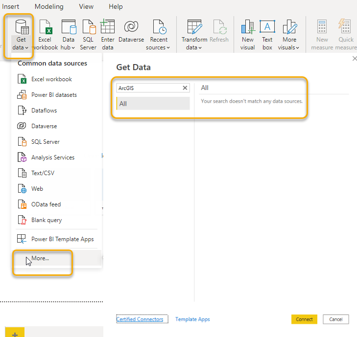

After engaging in a 5-day crash course in learning "Almost All the Maps for Power BI" to support a gang of customers, it dawns on me that maybe one of the first ideas for "ArcGIS Maps for Power BI" or "ArcGIS for Power BI" should be right at "Get data", where it all starts for Power BI users. If I search for "ArcGIS", "Esri", "spatial", "location", or any key words of Esri's choice, I would expect to get a pick list along the lines of:
- Map service
- File geodatabase
- Enterprise geodatabase
- Shapefile (yes, even 30 years later. or no, I personally don't really care to use shapefiles ever again, but my customers seem to love them.)

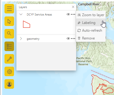

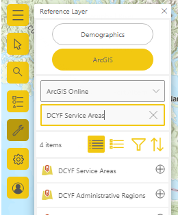

- Power BI > ArcGIS Maps for Power BI > wrench thing > search/find/add "reference layer"
- Layers > ... > add "Add to Power BI" launcher that converts to CSV with geometry column so I can join and relate that with my other stuff, then get on back to the map and other visualizations. Stick it right above "Remove" maybe?
