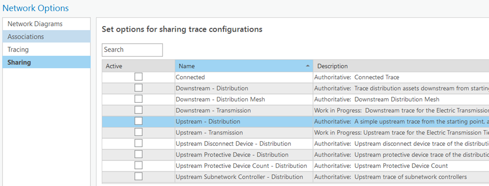

Trace Configurations Naming Standards
In my team, multiple Solution Engineers were adding trace configurations without naming standards, and it got confusing rather quickly. Based on the data available in the Network Options – Sharing dialog, I couldn’t infer much details about its configuration, such as purpose, tier, status, etc. Coming up with a standard naming convention with meaningful details was necessary for Named Trace Configuration to be efficient, especially when working in groups. At a minimum, I suggest having the naming standard along with a meaningful description to answer these questions:
- What Tier is this trace running against?
- Is this trace ready to be used in Fields Maps or a Web App?
The naming convention used in the screenshot is: <Trace Type> - <Tier Name>.
- Upstream – Distribution
- Upstream - Transmission
If your Utility Network has multiple industries (ex: Electric and Communications), adding a industry prefix would be useful.
- Elec: Upstream - Distribution
- Comm: Upstream - Cable
In the description attribute, I used the keywords “Authoritative” and “Work in Progress” to signify the status of the configuration. This gave confidence to my team members that they are using vetted Named Trace Configurations in their workflows and Web Maps.

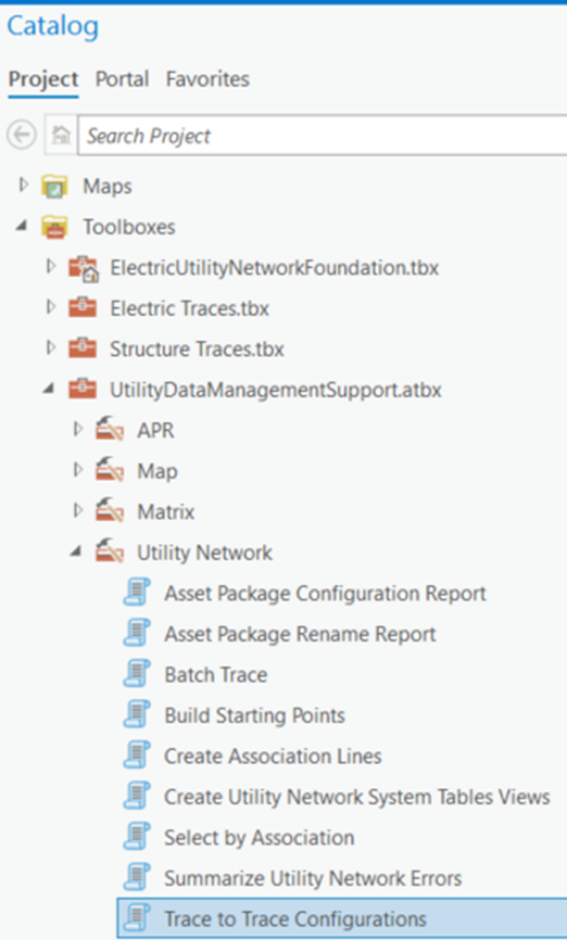

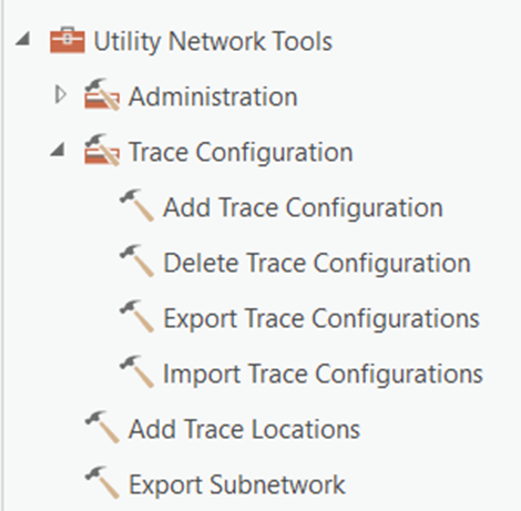

Trace to Trace Configuration GP Tool
Using ArcGIS Pro 2.9.x, in the core Utility Network Tools GP toolbox, there is no GP tool to import the results of a trace into a Named Trace Configuration. However, there is an Esri downloadable python toolbox called, Utility Data Management Support tools, that provides functionality to import the results of a trace into a Named Trace Configuration along with many other useful tools.
Details and download directions for the Utility Data Management Support toolbox are located here.

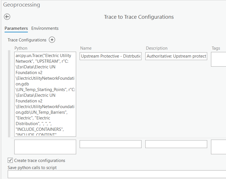

Upon adding the Utility Data Management Support toolbox to your ArcGIS Pro Project, you can use the “Trace to Trace Configuration” GP tool to take python syntax for a successful trace execution and create a new Named Trace Configuration.

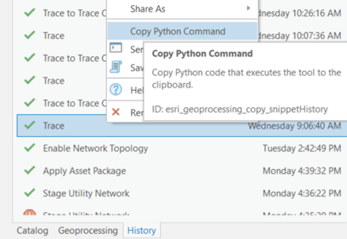

Here is the workflow to create the Named Trace Configuration from trace results
- Manually configure the Trace GP tool with the parameters you need and run the trace
- Open this History tab, right click on the Trace entry and select the “Copy Python Command"
- Open the Trace to Trace configurations GP tool and paste the python command into the “Python” text box
- Enter a Trace Configuration Name and Description and hit the run button
- Note: This screen shot was taken in March 2023. You'll need to download the latest Utility Data Management Support toolbox if you are seeing an older version of this GP tool.

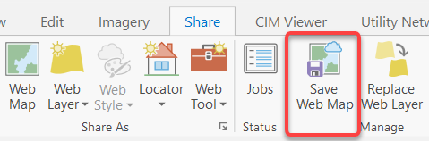

In ArcGIS Pro, there are no capabilities to overwrite an existing Web Map in Portal. However, you can make changes directly in portal’s Web Map and then save those changes.
- In ArcGIS Pro, open the Web Map from Portal
- Catalog Pane – Portal --> Right click on Web Map --> Add and Open
- Once the map is loaded, notice the “links” in the icon. This indicates it’s linked from your Portal
- Make your Named Trace Configuration assignments
- To save the Web Map to portal: From Share Tab --> Save Web Map (in Manage group)
- Note: The Save Web Map button is only enabled when a "linked" Web Map is the active map

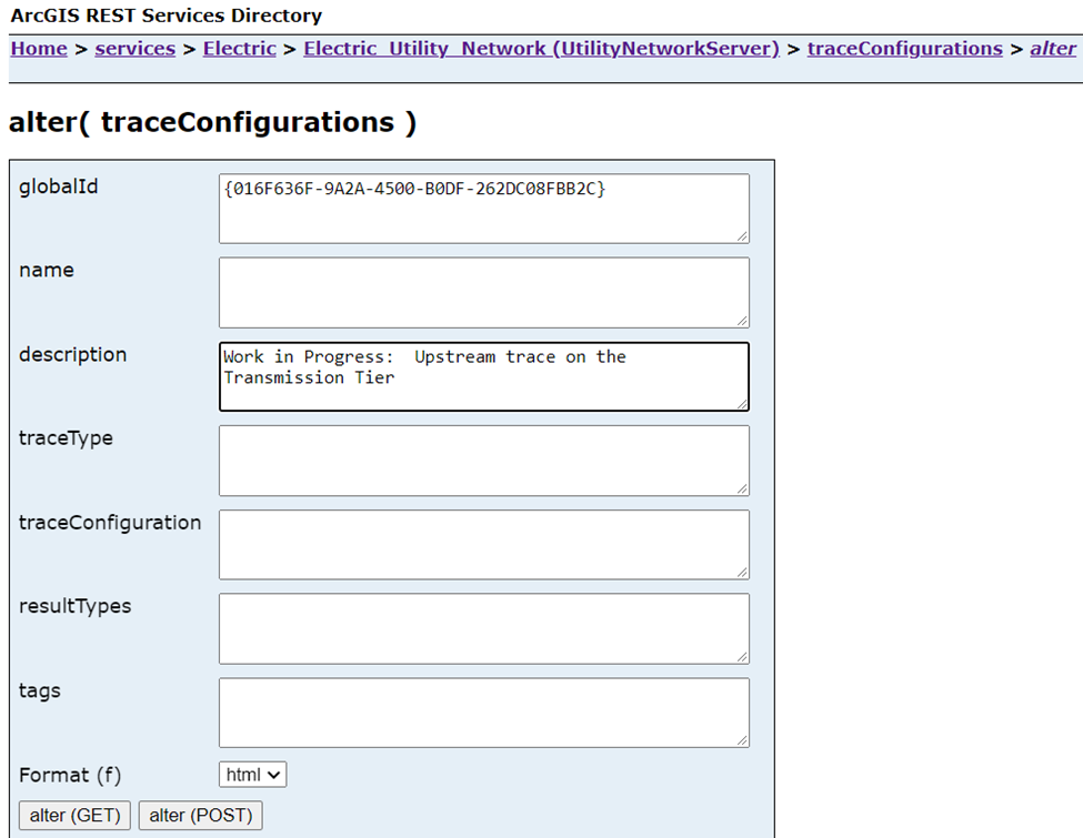

How can I update an existing Named Trace Configuration?
You may have noticed that the Trace Configuration toolbox doesn’t contain an Update tool.
There are currently no means to update any of the settings of the Named Trace Configuration from ArcGIS Pro. The only option is to use the Trace Configuration REST API’s Alter command.
- I strongly recommend reviewing the REST API documentation before making any changes. There is no undo operation with the REST API.

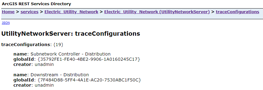

The Alter documentation informs us that the globalID parameter is required and that all others are parameters are optional. To get the Trace Configuration Globalids, follow the path in the screenshot.
Using the screenshot below, when the alter (Post) button is clicked, the only attribute that will be updated is the description.
I’ve been using this REST API to update the descriptions and occasionally the name.
I avoided the traceConfiguration parameter as it is a complex JSON object. Unless you are comfortable with JSON and Fiddler, I suggest creating a new Named Trace Configuration within ArcGIS Pro as opposed to updating the traceConfiguration from the REST API.
Note: If you change the name of a trace, you will need to save your Web Map(s) again from within ArcGIS Pro for it to recognize the new name.
