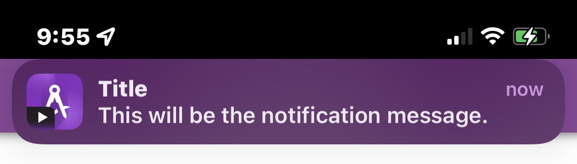

The above example would display a notification that looks like the below image after 10 seconds.
