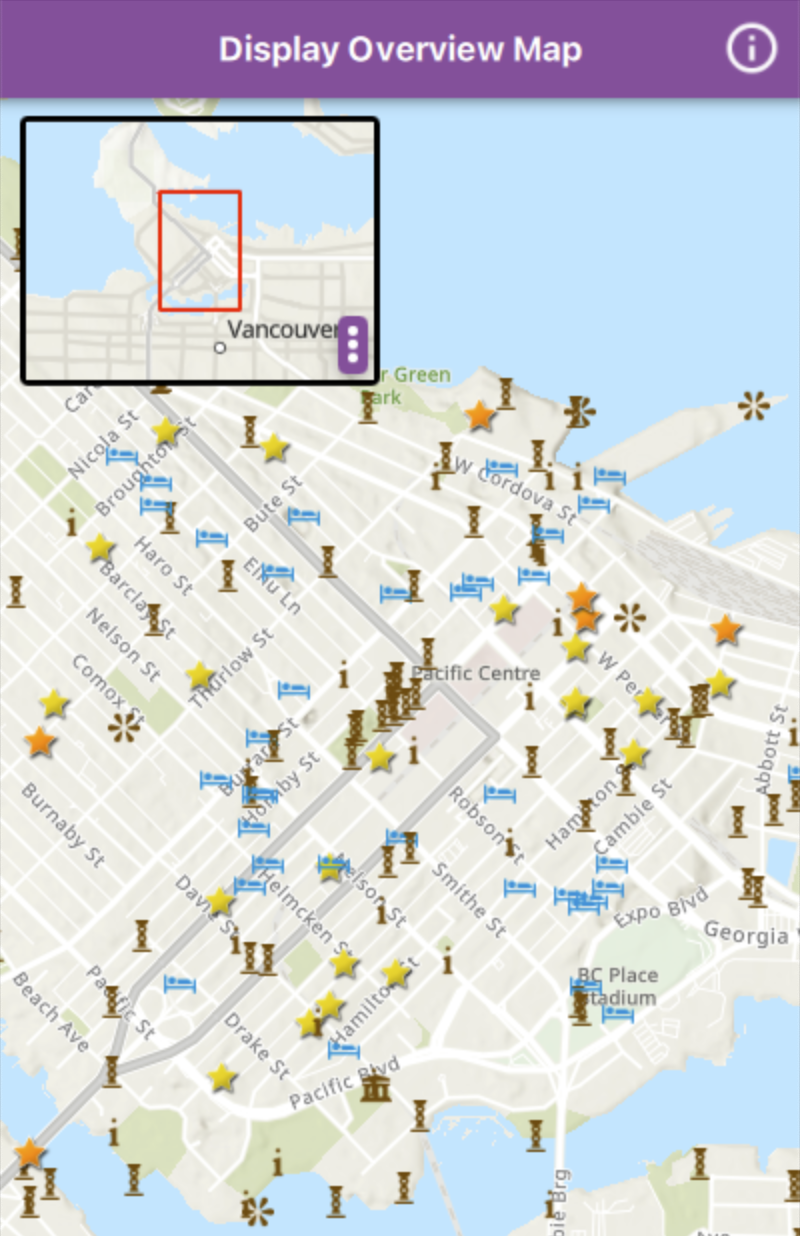

An overview map displays the extent or boundary of another map with a zoomed-out view. Think of a map that is zoomed in far enough to be able to see and read street names. The overview map would be a zoomed-out view of this map to show the city or state the main map view is displaying. It is a great tool to provide more context without taking up to much screen real estate or stealing the viewer’s focus.

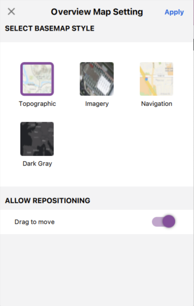

In this sample, we added 2 additional settings we thought were necessary for the custom component. Included in this component is the ability to switch base map styles between 4 options: Topographic, Imagery, Navigation, or Dark Gray, and the overview map position can be unlocked so the user can drag and move it to any location on the screen.
