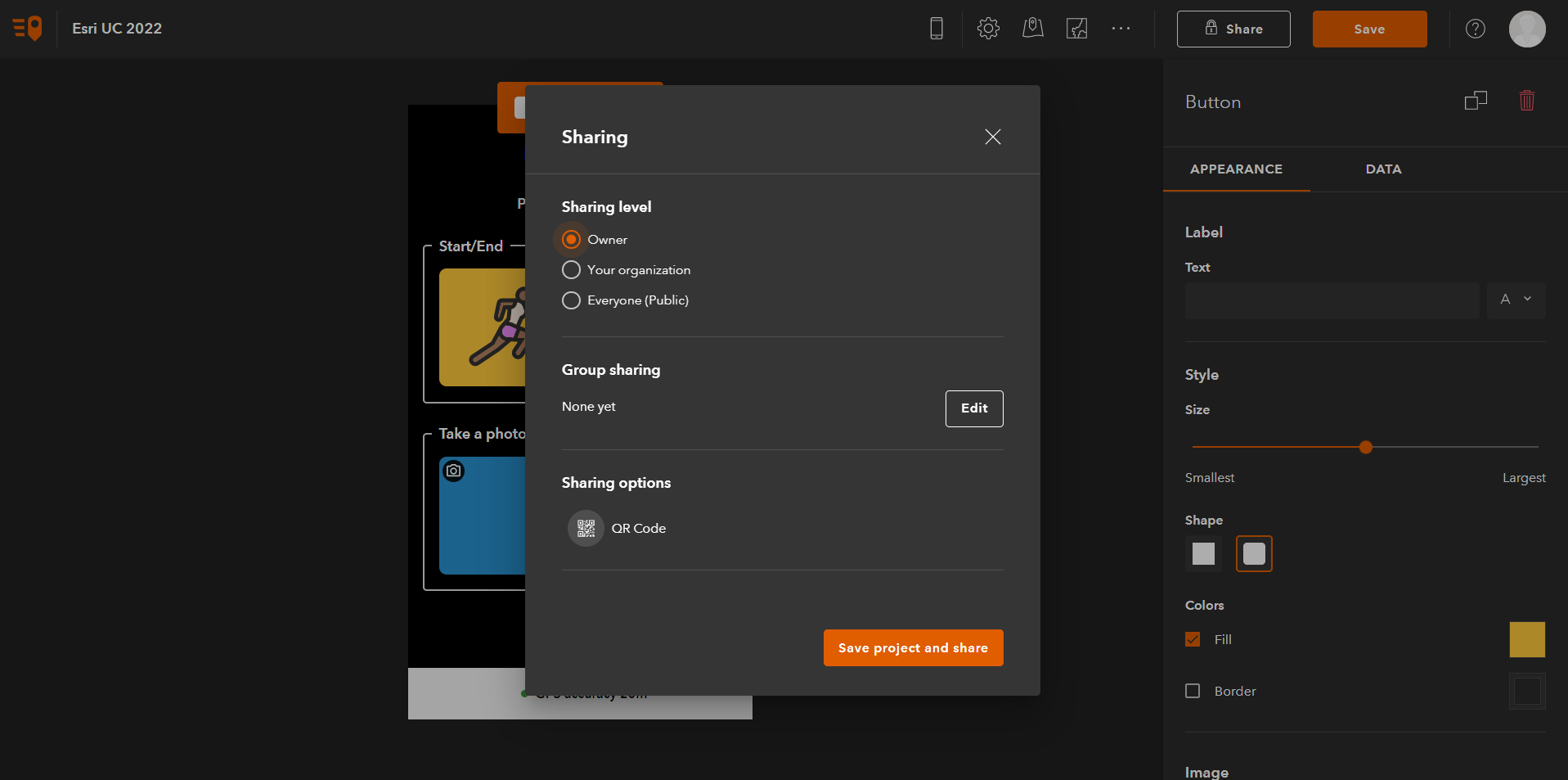

Some of you requested that we make the QR code of a project accessible even before the project is shared. As shown in the screenshot below, the QR code is now always available.

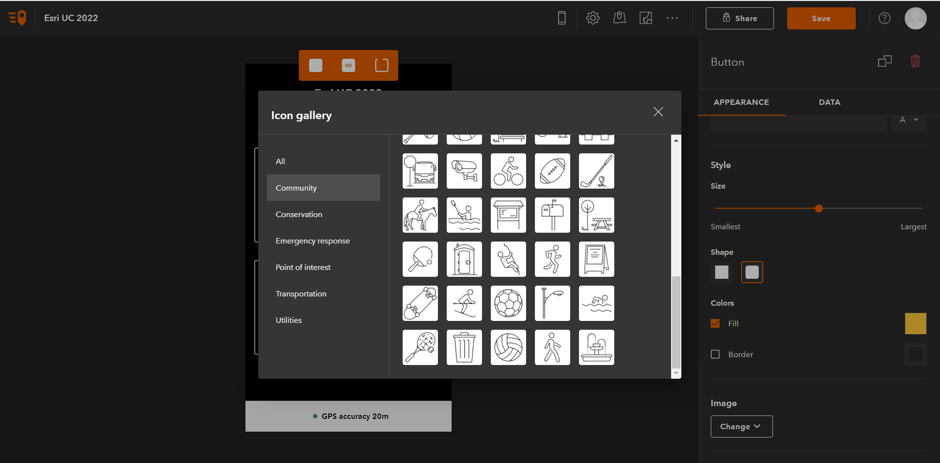

A new set of new icons has also been added to the gallery.
