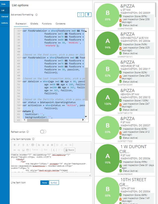

Before we dive in, let's look at the end result, above. Advanced formatting with Arcade is bringing critical information to the forefront of the indicator. The color of the large circle is changing, depending on the overall inspection score, and the icons are changing in the inset table, depending on if the values are above or below a certain pass/fail threshold.
Here is the Arcade Advanced Formatting:
Note that this arcade references two .png images (the X and Check). You'll want to download those images below and re-host them in your own organization. Then update the HTML to point to this file.
//update these icons to point to your own content
var passIcon = "https://healthgis.maps.arcgis.com/sharing/rest/content/items/a78a97f510384b6c8f534b914871648f/data"
var failIcon = "https://healthgis.maps.arcgis.com/sharing/rest/content/items/6bf6f2dac2384861ab0ebc3da97c3834/data"
//Truncate the restaurant name so it doens't go into two lines
var nameTrunk = iif(count(Text($datapoint.CONAME))<15,
$datapoint.CONAME,
Left($datapoint.CONAME,14)+"...")
//calculate how long ago the last inspection was in days
var startDate = Date($datapoint["Inspection_Date"]);
var endDate = Today();
var age = floor(DateDiff(endDate, startDate, 'days'));
//if the last date of inspection was more than X days ago, generate different colors
//this is currently unused in the html
var alertColor = When(age >=0 && age < 90, '#69B34C',
age >=90 && age < 180, '#FAB733',
age >=180 && age < 365, '#FF8E15',
age >= 365, '#FF0D0D',
'NA');
//based on the % score, convert to a letter grade
var foodScore = $datapoint["Inspection_Score"]
var foodGrade = When(foodScore >=0 && foodScore < 55, 'F',
foodScore >=55 && foodScore < 70, 'D',
foodScore >=70 && foodScore < 80, 'C',
foodScore >=80 && foodScore < 90, 'B',
foodScore >= 90, 'A',
'NA');
//based on the score, assign a color to be used as a background
var foodGradeColor = When(foodScore >=0 && foodScore < 55, '#cf4c14',
foodScore >=55 && foodScore < 70, '#df903b',
foodScore >=70 && foodScore < 80, '#caca36',
foodScore >=80 && foodScore < 90, '#98da7f',
foodScore >= 90, '#69B34C',
'#f8f8f8');
//based on the food score, pick a pass or fail icon
var foodGradeIcon = When(foodScore >=0 && foodScore < 55, failIcon,
foodScore >=55 && foodScore < 70, failIcon,
foodScore >=70 && foodScore < 80, failIcon,
foodScore >=80 && foodScore < 90, passIcon,
foodScore >= 90, passIcon,
failIcon);
//based on the last inspection date, pick a pass or fail icon
var dateIcon = When(age >=0 && age < 90, passIcon,
age >=90 && age < 180, failIcon,
age >=180 && age < 365, failIcon,
age >= 365, failIcon,
failIcon);
//based on the facility status, pick a pass or fail icon
var status = $datapoint.OperatingStatus
var activeIcon = When(status == "Active", passIcon,
failIcon);
return {
textColor: '',
backgroundColor: '',
separatorColor:'',
selectionColor: '',
selectionTextColor: '',
attributes: {
daysSinceInspection: age,
foodGrade: foodGrade,
alertColor: foodGradeColor,
foodGradeIcon: foodGradeIcon,
dateIcon: dateIcon,
nameTrunk: nameTrunk,
activeIcon: activeIcon
Here is the HTML:
<table border="0" cellpadding="0" cellspacing="0" style="height:150px; width:100%">
<tbody>
<tr>
<td height="150px;" rowspan="6" style="background-color:{expression/alertColor}; border-radius:150px" width="150px;">
<h1 style="text-align:center"><span style="color:#ffffff"><strong>{expression/foodGrade}</strong></span></h1>
<h3 style="text-align:center"><span style="color:#ffffff"><span style="font-size:18px">{Inspection_Score}%</span></span></h3>
</td>
<td colspan="2">
<h3> {expression/nameTrunk}</h3>
</td>
</tr>
<tr>
<td colspan="2"><span style="font-size:16px"> {STREET}<br />
{CITY}, {STATE} {ZIP}</span></td>
</tr>
<tr>
<td style="background-color:#edf2f2; border-color:white; border-style:solid; border-width:0px; text-align:center"><img alt="X" src="{expression/foodGradeIcon}" style="height:20px; width:20px" /></td>
<td style="background-color:#edf2f2; border-color:white; border-style:solid; border-width:0px"> Inspection Score ({Inspection_Score}%)</td>
</tr>
<tr>
<td style="background-color:#edf2f2; border-color:white; border-style:solid; border-width:0px; text-align:center"><img alt="X" src="{expression/dateIcon}" style="height:20px; width:20px" /></td>
<td style="background-color:#edf2f2; border-color:white; border-style:solid; border-width:0px"> Last Inspection Date ({expression/daysSinceInspection} days ago)</td>
</tr>
<tr>
<td style="background-color:#edf2f2; border-color:white; border-style:solid; border-width:0px; text-align:center"><img alt="X" src="{expression/activeIcon}" style="height:20px; width:20px" /></td>
<td style="background-color:#edf2f2; border-color:white; border-style:solid; border-width:0px"> Status ({OperatingStatus})</td>
</tr>
</tbody>
</table>
<p style="text-align:center"><span style="font-size:12px"><em><span style="color:#999999">(LIC#{License_Number})</span></em></span></p>

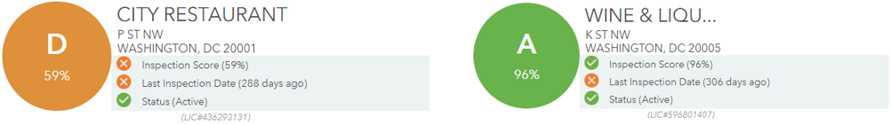

When all is said and done, you should see this:
As always, I'm not an Arcade expert and I welcome updates to this code!
