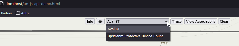

I try to figure out how to share a named trace configuration in order to use it through ArcGIS Enterprise.
What I have done so far :
- share a UN service to ArcGIS Entreprise 10.9
- create a webmap in Pro that uses the UN services
- add trace configurations to the map and enable sharing option
Now they are properly listed in my UN properties :
- share the webmap with Portal
Now I want to use this trace with the un-js-api-demo from https://github.com/hussein-nasser/un-js-api-demo
- connect the html exemple to the portal and webmap ItemID
- the authored traces are listed
- when tracing after adding a starting point :
{"success":false,"error":{"extendedCode":-2147208597,"message":"Un paramètre requis est absent du fichier JSON.","details":[]}}
--> parameter missing from the JSON file
Any idea ? Is the trace JSON configuration saved within the webmap JSON ?
