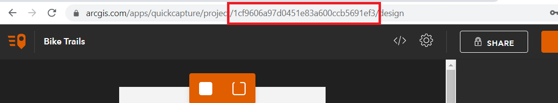

- <item id> Should be replaced with the item id of the project that you want to download/open. In the example above it was: ee28345410cc4647a74ef66f54f237e
This item id can be easily obtained from the URL of the project when opened in the Quickcapture Web Designer.
