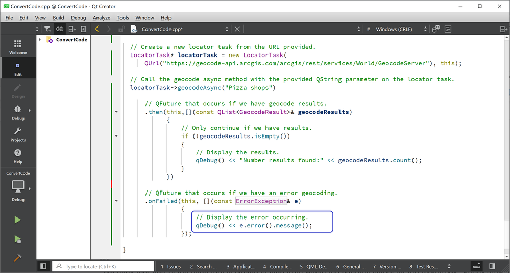

Code conversion Step 6
The next coding change we need is to copy everything that was in the older pattern for the connect slot for the LocatorTask::errorOccurred inside of the curly brackets into the curly brackets for the QFuture's .onFailed() handler. This is best demonstrated with some screenshots.
We copy that part of the code that is circled in blue from within the connect signal for the LocatorTask::errorOccurred inside of the curly brackets:
Into the curly brackets for the QFuture's .onFailed() handler (the copied section is circled in blue):
Code conversion Step 7
