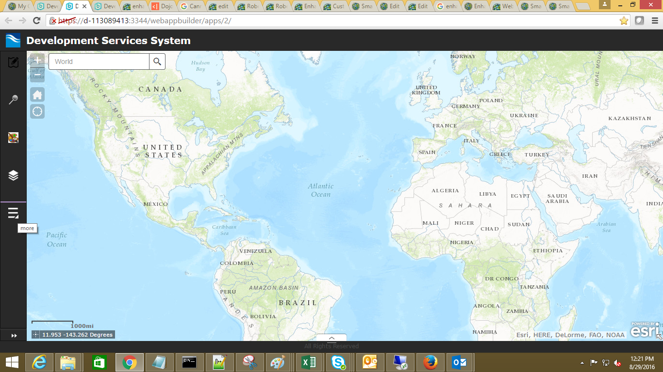

     I want to add one more widget to Side Bar Controller in the Tab Theme (below the widgets which are already added i.e., 5 widgets) . In Tab theme, there we can add only 5 widgets, and if we add more than 5, then 5th, 6th and so on... widgets are going inside the "more". If we open "more", we could able to see the widgets which are newly added. Now I want to add 6th widget, but it should not be add to "more". It should be visible as the 6th widget below the 5th widget. Can I add like that?
Please suggest me....
I'm adding screenshot here for reference...
Thanks in advance....
