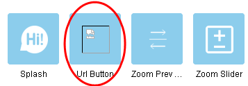

Robert, I need a quick refresher. It's been awhile. I added the UrlButton Widget to my apps folder under Widgets.
Two issues:
1) The URL Button auto-launches to the URL from www.esri.com everytime I open the App for editing.
2) The icon is empty. I kept the original name.

RobertScheitlin__GISP
MVP Emeritus
Tim,
  It sounds like you are try to manually add the widget and configure it. You should be following these steps:
  1. Add any new custom widget to the client\stemapp\widgets folder.
  2. Restart WAB
  3. Open the app in WAB to configure and add widgets in the widgets tab.
  4. You will see the new custom widget you added in step 1 now.
  5. Add the widget and the widgets settings dialog will appear.
  6. configure the new widget to your liking.
  7. Save your app
  8. Done.

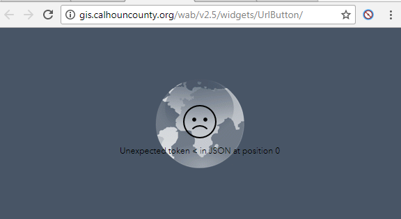

LuisGarcia3
Hello Robert, Thanks for this!
Just one question: I am getting into Web AppBuilder so I would need some help with this.
I really need to use your widget and I would like to know how to put it on my widget´s library and to make it work... I know this question can look silly but I am not an expert haha

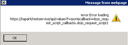

Now i changed your Url Button code so that when clicking on the button  it will call a webservice.
I changed the widget.js code to:
define([
'dojo/_base/declare',
'dojo/_base/lang',
'jimu/BaseWidget',
'jimu/WidgetManager',
'esri/request'
function (
declare,
lang,
BaseWidget,
WidgetManager,
esriRequest) {
var clazz = declare([BaseWidget], {
baseClass: 'widget-urlbutton',
isOpening: false,
onOpen: function () {
if (!this.isOpening) {
this.isOpening = true;
//window.open(this.config.LinkUrl, "_blank");
var requestHandle = esriRequest({
url: "http://tapat4/restservice/api/values",
content: { f: "json" },
handleAs: "json",
callbackParamName: "callback"
requestHandle.then(
function (response) {
alert('success');
//console.log("Success: ");
}, function (error) {
alert('error:'+error.message);
// console.log("Error: ", error.message);
//RJS End Edit
setTimeout(lang.hitch(this, function () {
this.isOpening = false;
WidgetManager.getInstance().closeWidget(this);
}), 300);
} //if this opening open
} //on open
}); //clazz declare
return clazz;
}); //function
When running the app after refresh and clicking on the url button i get the message alert that it can not load the rest service.
Do you have any idea what i am doing wrong?And how can i check the error?
Cause when i run in explorer the url of the webservice : http://tapat4/restservice/api/values i get a json file with the response!
Thank you so much for your help
MVP Emeritus
Is the service a RESTfull web service or a SOAP based web service?
CarolineBettach
 I make a test with a restfull service and I succeed make it works by removing the parameter :
Is it possible to make it works with a soap service ?
