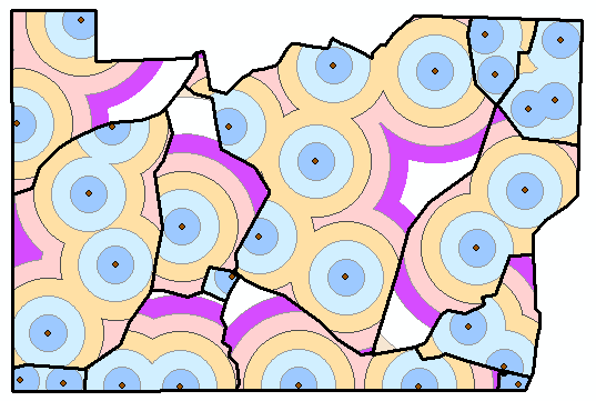

I am trying to create a buffer of water locations (point.shp) within a pasture (polygon.shp).  When i run a multiring buffer of the water locations the rings extend beyond the pasture fence lines.  I need to rings to stop at the fence lines.
you can see from my map that the water locations need to stay within the pastures but as of now the rings go beyond the pasture lines.  I was able to clip the buffer by the outside of the polygon file so the rings don't extend beyond the outside perimeter.  I need it to do this within the internal fence lines.
Any idea on how I can do this.

Is this more or less what you are trying to get?

You will probably have to script this or créate a model:
  • Loop through each fence polygon
    • Select the water points inside the current polygon
    • Do the multiring buffer
    • Clip with the current fence polygon
AndrewBivins
Yes,
That is exactly what I am trying to do. How did you manipulate my data. I only sent a pdf correct? Bigger question is how did you get the buffers to stay within the borders of the individual polygons?
XanderBakker
Esri Esteemed Contributor
I converted the PDF to raster, changed the raster, did some vectorization and made some edits (added some additional water points).
The unpolished code I used I included below.
  • It creates a list of OID's of the fence areas
  • Loops through the list of OID´s
    • creates a featurelayer with only the current fence area based on OID
    • creates a featurelayer with only the water points in that area
    • creates the multi ring buffer on those points
    • clips the resulting buffers with the area
