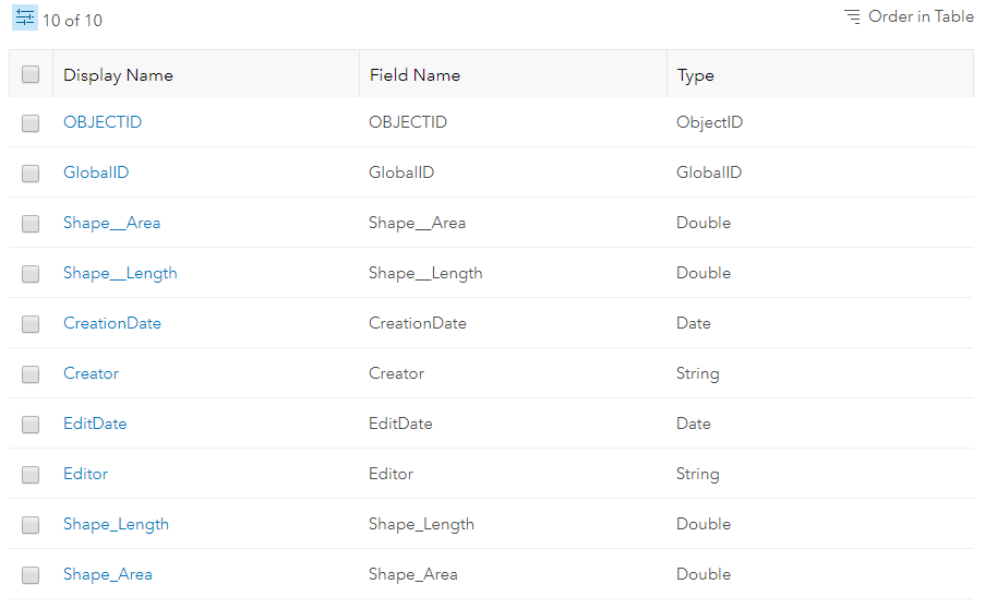

I have a hosted polygon feature layer in AGOL. It has the default shape length and area fields (Shape__Length, Shape__Area), and it has two additional fields which I created called Shape_Length and Shape_Area:

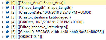

Note that the double quotes are actually part of the attribute name. I've tested this with several hosted polygon feature layers and the behavior is always the same. Here is a screen shot of the Feature object's attributes:
Also note that the actual attributes Shape_Length and Shape_Area are not present in the feature
