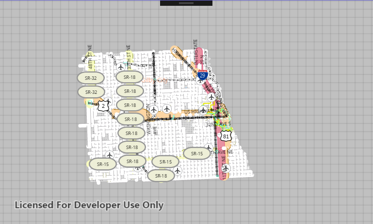

Hopefully to give you a better idea of the issue...
What the map looks like in ArcGIS Pro:
What the map looks like when loading the MMPK into a simple WPF app:
Many things don't seem to be sizing correctly, some labels are completely missing (or I now notice barely showing up) for unknown reasons (the city names highlighted in orange).  The thick white lines throughout the county appear to be the roads that shouldn't be showing up with the scale sizing.
Any help or clarification on these differences would be greatly appreciated!
