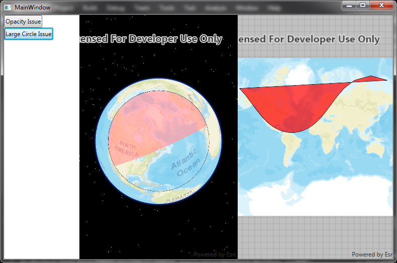

The app I'm working on requires that we show the "horizon" associated with what an object (say a satellite) in space can see, based on its altitude and FOV. I typically can render this with no problem, except when the horizon circle contains the north pole, then all sorts of weirdness can happen. Here is an example:
On both the sceneview, the black outline correctly denotes what I expect to see, but the polygon doesn't fill  correctly.
On the mapview, I expect to see something that looks like a sine wave filled in from the top.
In neither case did I get what I expected.
I've attached the code that generates this image. Run it and click the "Large Circle Issue" button.

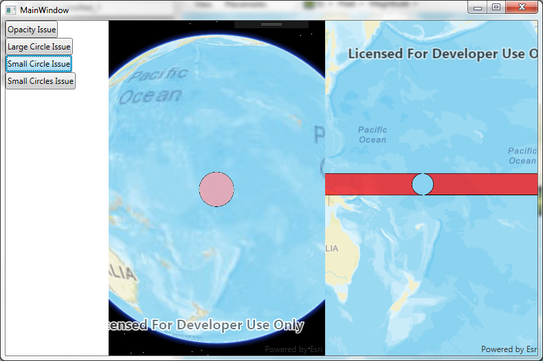

Placing a small circle directly on the antimeridian (at 180 or -180 lon) creates the following picture:
And, even worse, when I try to draw a donut (a circle with a circle subtracted from it), I get this:
I will update the attached App. The first picture above relates to the "Small Circle Issue" button and the second to "Small Circles Issue".

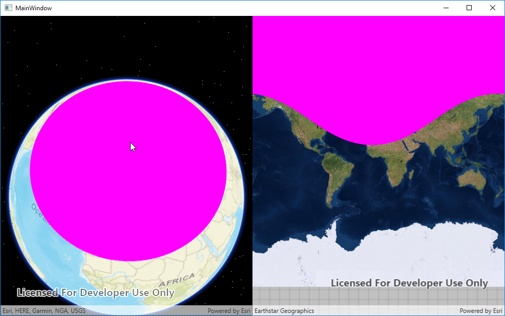

There are rendering issues in the SceneView with polygons that span the pole and we have a bug logged to address these. Using BufferGeodetic or EllipseGeodetic should give you the desired result for the geometry. In terms of a workaround to improve the rendering (until the rendering issues are addressed), you can set the GraphicsOverlay.RenderingMode property to RenderingMode.Static, and set a null outline on the fill symbol. That should have it looking like the example below.
