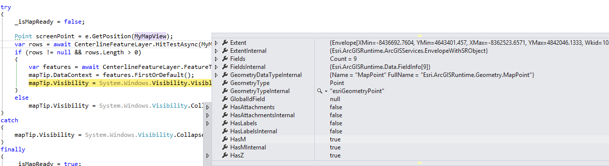

I have a map service and when I call
     await MyLayer.HitTestAsync(MyMapView, screenPoint)
with a point feature layer everything works.  When I switch to a polyline feature layer I get a popup message box that vshost32.exe has stopped working and I cannot debug from my visual studio window and the app crashes.
Does HitTestAsync support polylines?

Here is the code that reproduces the issue against our FeatureLayer.  Our layer is M-Aware (HasM = true) and its spatial reference is 4269.  I can reproduce with our point layers that also has HasM = true.  Using the same code sample I cannot reproduce the issue using this layer hosted by ESRI - Layer: Highways (ID: 1)

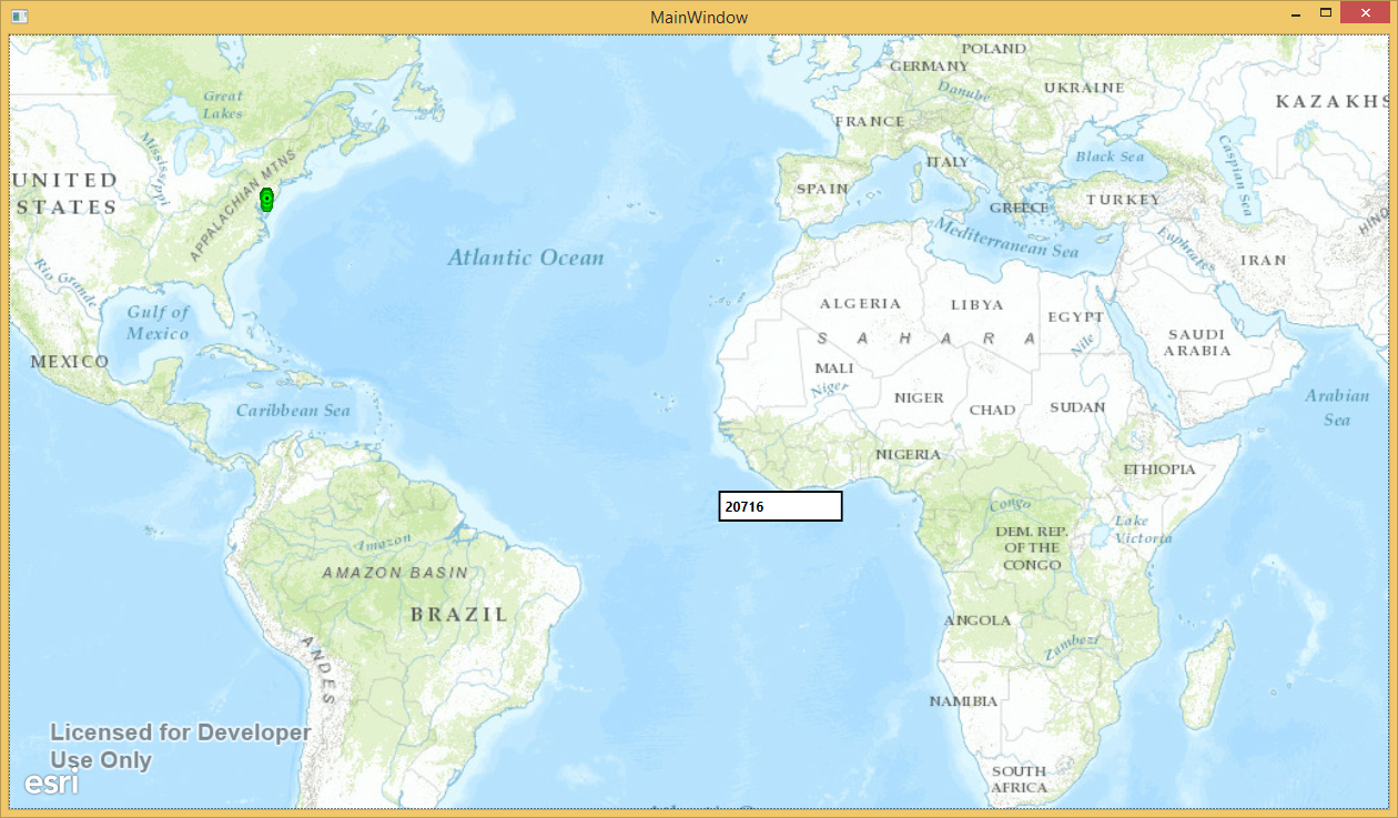

JenniferNery
Did you await RequestPointAsync? It should return a geometry as soon as you tap or click on the map. The TaskCanceledException may have been triggered by the next call to RequestPointAsync, this will cancel previous async call that has not returned.  You can also use MapView.MapViewTapped event to get the screen point for hit test.
Could you also share code to reproduce the crash on hit test? Are we using the same version of the API? Are you using WPF, Store or Phone application?

I see now why you would get TaskCanceledException if you copied the code I provided from click event handler. Your sample is using MouseMove, which will fire numerous times. Thus starting another RequestPointAsync call which cancels previous async call. I was only using RequestPointAsync to get a screen point but you're free to use e.GetPosition() from MouseEventArgs.
Going back to the original issue. I tried using your sample as is with my own m-aware service. Your sample uses hit test result to query the table for features.
The only thing, I changed was the binding statement since DataContext of the overlay is set to graphics and you want access its Attributes.
<TextBlock Text="{Binding Attributes[OBJECTID]}" />
I did not get a crash though.

Ok so I suspect it might be something with my map layer then if that code works for you.  I initially suspected that it was because my layer is m-aware, but I guess you have eliminated that.  Do you have any suggestions for how to identify what could be causing this crash on my layers?  The geodatabase is at version 10.1sp0 for Oracle 11g.
I did some testing with additional layers and I found a difference between the layers that work and the layers that don't work.  The layers that cause the crash are part of a group layer.  Could you test this on your side and see if sub-layers that are part of a group layer crash?
I tried using the following code and it crashed as soon as it iterated over my layer and called HitTestAsync -
