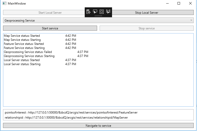

I installed Visual Studio 17 with ArcGIS Run time for .Net 100.4 version and installed Local Server 100.3 as mentioned in Guide .
Local Server tested with below sample:
Local Server Services—ArcGIS Runtime SDK for .NET Samples | ArcGIS for Developers opers.arcgis.com/net/latest/wpf/sample-code/localserverservices.htm
Local server is Starting and then failed when i am using Geo processing service. but when  i am selecting the Map service and Feature service it stated well . as show in below.
Please provide solution for this issue.

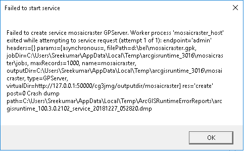

Hi Jennifer,
Thanks for your reply.  attached the error snap.

Hi,
You will need to enable additional deployment options for geoprocessing - for more information please see Local Server—ArcGIS Runtime SDK for .NET | ArcGIS for Developers.
