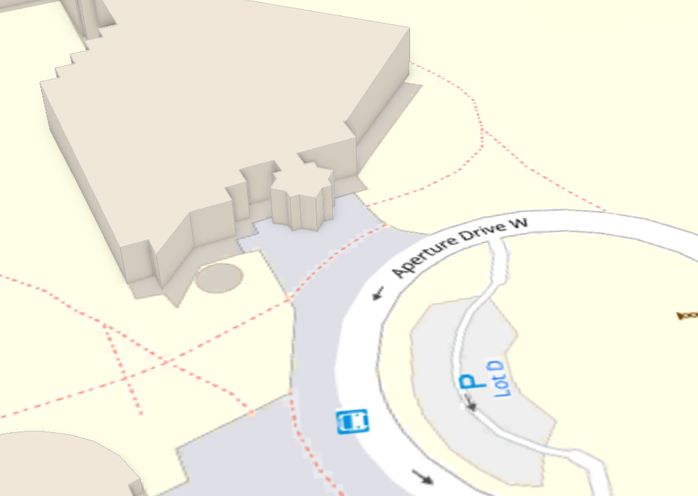

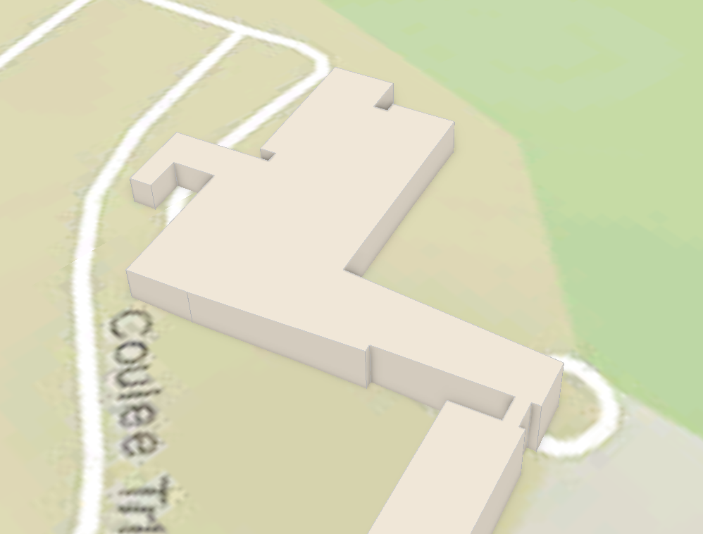

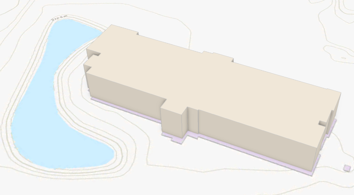

The specific issue I'm having is that the built-in basemaps don't match the real-world at the small scale that I'm at. Here's some examples:
With the Topographic basemap, the buildings aren't aligned properly. Ideally, I'd like to just remove buildings from the basemap entirely
With the Light Gray Canvas basemap, the pond is in the wrong location, and it's very pixellated
With the National Geographic basemap, the roads aren't correct
The closest I've found is the OpenStreetMap basemap, but the default style is very visually unappealing, hence why I was trying to implement my own style.
