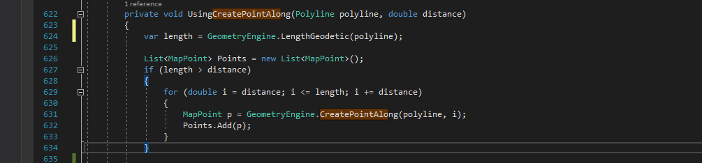

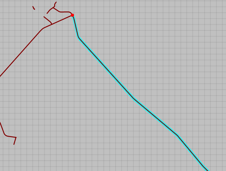

My requirement is to add points at specific distance on a polyline. In Order to achieve this I have a poly line of 26 Kms length, So i used CreatePointAlong method to add points on poly line for each 2 Kms distance, but it's adding the point always at the starting point. Here i'm attaching the screen shots. Is there any way to achieve my requirement? please suggest.
Thanks in advance

Naresh_KumarK
Thanks for the response Ted Kowal,
My application environment is .net using C# programming.Can we achieve the same above  in c# programming?
For your information I'm extracting the poly lines from a shape file by creating a feature layer. is there any problem with my code? please help

I do not program using  ArcgisRuntime but use ArcObjects (VB.Net Programmer).  Given my lack of familiarity with Arcgisruntime and C#  looking at you code snippet... it appears to be fundamentally correct in setting up the symbology.  However you are only simply displaying the shapefile line work?  I am assuming that arcgis runtime has access to the the generatepointsalonglines toolbox.
Naresh_KumarK
Thank you for the response Ted Kowal, Yes I'm just displaying the poly lines as they are from Shape file to the map and then i'm trying to process them.

Additionally you can use Create Point along Line and loop through the distances you desire.  GeometryEngine.CreatePointAlong Method
