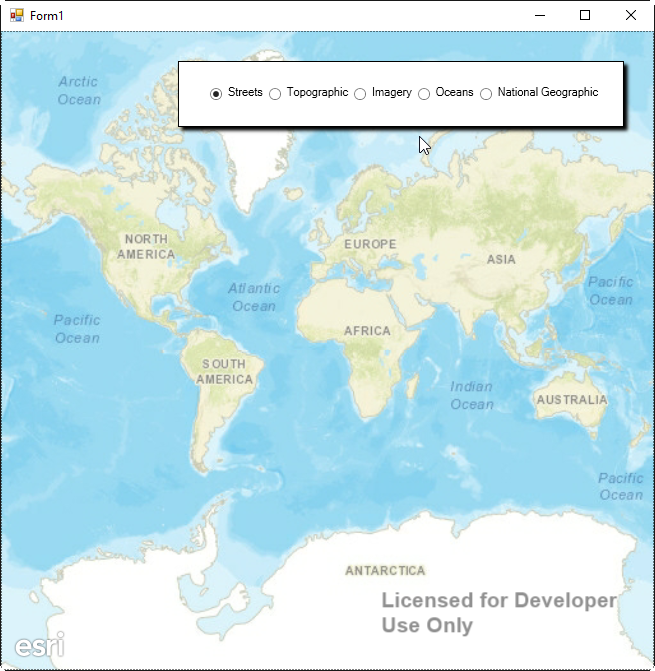

Hi,
You can, by hosting our WPF-based MapView control in your Windows Forms environment via the WinForms ElementHost control.
My advice is to only do this if you really need to support an existing WinForms application, and perhaps while you migrate that application to a more modern platform such as WPF or even Windows Store/Phone/Universal.
