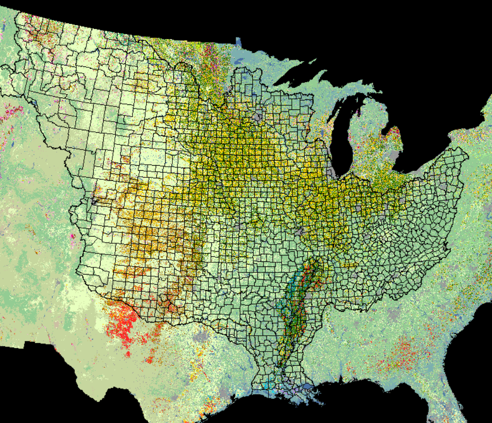

Hey everyone,
I have a 2017 Land use-Land Cover map of the US that I'm trying to reclassify. It has 256 different values right now and my plan is to only have nine at the end - a few crops I care about and 'other'. I made a table in Excel that I'm trying to import into the reclassify tool so I won't have to change 256 values in ArcMap by hand.

Here's an example of my data
Land Use Map example

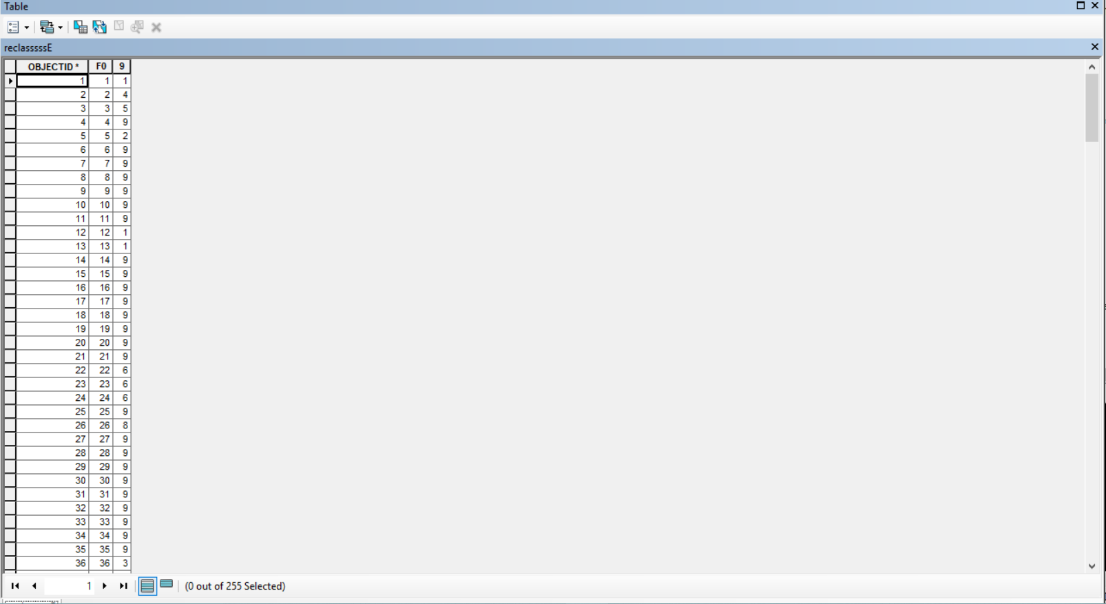

EricSimpson1
Here's the table in question. Part of it, at least.
DanPatterson_Retired
MVP Emeritus
the 'to' field name is a number... probably not good.  How did that happen?
EricSimpson1
Y'know what, I goofed up. The first row was 0,9 and should have been something to be converted. I'll try giving them some normal names and let you know.

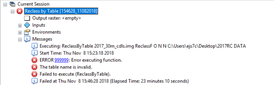

EricSimpson1
I fixed the column names to "O" and "N" and it still failed, here's a screengrab of the failure in the results
MVP Emeritus
Ok... simple folder, not users and not a folder that begins with a number especially if you aren't specifying a file a file extension for the output raster since it will default to an esri grid which won't accept numbers for the first letter of the name and no spaces and less than 10 characters.
Is your table IN a geodatabase (just checking).
Where is the input raster stored? (check the "Inputs" section of the error message
Make sure you specify a file extension (tif is preferred) for the raster AND put it in a folder … ie c:/myfolder/MyReclassedRaster.tif
ChrisDonohue__GISP
MVP Alum
Besides what Dan Patterson specified, ensure there are no spaces in filename and folders.  Having a space can be the kiss of death when running raster processes.  If a space was used for clarity, use an underscore _ instead.
For example, the path showing in the run message appears to end with "2017RC DATA".  Throw an underscore in there instead of the space.  I.E. "2017RC_DATA".
It terms of file naming and structure, Rasters are finicky...
