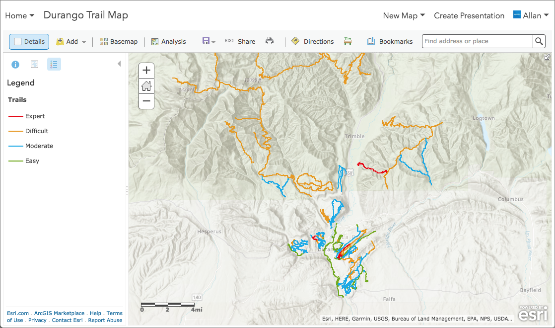

This web map has been designed with the World Vector Tile Topographic basemap, an overlay of World Hillshade 50% with transparency, and with a trails layer on top that have been classified by difficulty. The popups have also been customized to display textual information as well as some field data.
You can view the map or make your own copy of this one here.
