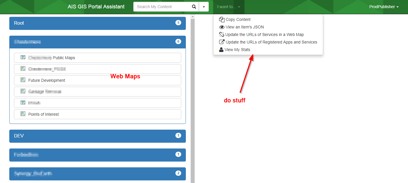

If you need to copy the APP to different environments you use Portal Assistant to COPY CONTENT (>> different Portal ) which copies the Web MAP.  You then use Portal Assistant again to change the REST service paths.  Save.  (takes 2 minutes).
For the web app. use Visual Studio Code to Find replace the Portal Path, ItemID and environment Paths.  Takes 2 minutes.
Publish the web app to the new web server.  Done.
Ive even downloaded the GIS Portal assistant and customized.

AmyKlug
Gerry, I have found that with the Portal Assistant you can copy layers and maps between Portals, it does not work for apps that are built in Portal (the app must be re-created on the new Portal). Even if you change the json file in the assistant.
AmyKlug
I finally figured out how to copy content from one portal to another where Web AppBuilder DE links do not break. You actually have to go to the Portal server (where you copied the content to) and change the ID’s in this folder (location depends on where you put in upon install):
http://server.arcgis.com/en/portal/latest/administer/windows/changing-the-portal-content-directory.h...
You will find folders with all the item ID’s and inside are the item ID .json files (do not show extensions in my directory). I would not edit them directly so I had to copy them to my PC, edit them and then copy them back in to that folder (delete the old file). Notepad ++ has a nice feature that will search all files in a directory and replace, remember that came in handy during this process (widgets?).
You might have to change the widgets too. I’ve heard the “search” widget needs to be edited for some reason
