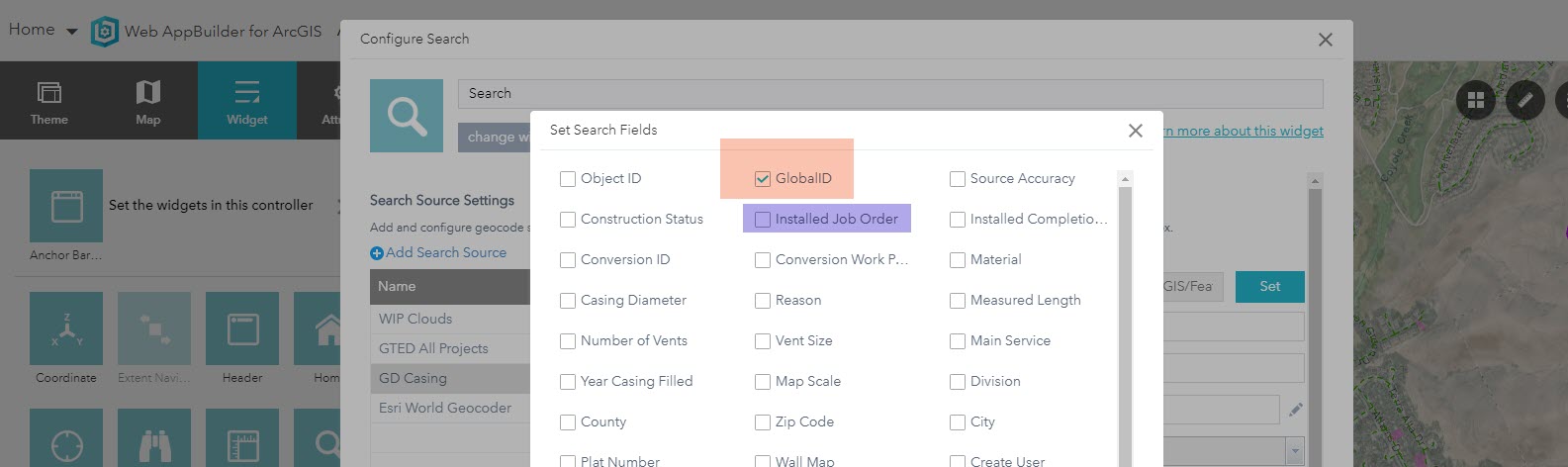

Web App Builder, why include the GLOBALID field in the 'Set Search Fields' configuration for the Search Widget when you cannot search by GLOBALID?
I spent several hours trying to get the search by GLOBALID and could never get it to work.  In fact, if I had it checked, then I could not search on other fields either.  However, if I unchecked it, then I use a different fields, such as, Install Job Order in my feature service.
Set Search Fields
The above example is from Enterprise Portal 10.6.  However, I also tried to use GLOBALID in AGOL and it did not work either.
Is there a workaround for searching by GLOBALID?

Hi Steve,
If you turn developer tools on in your browser, you will see that the Search Widget makes a wrong REST query.
GLOBALID = {1C53657E-E2D8-40B3-8214-6E48001F8485}
And it gets
{"error":{"code":400,"message":"Unable to complete operation.","details":["Unable to perform query operation.","Invalid query"]}}
Seems like a bug in a Search Widget, it should be adding quote around the GUID text. Its happening in 10.7.1 WAB as well. We circumvented it by adding another dummy text field with value as copy of GlobalID using Attribute Rules and search using this field. This works correctly.
UPPER(FUID) LIKE '%{1C53657E-E2D8-40B3-8214-6E48001F8485}%'
