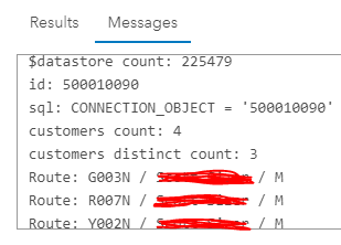

The fields [CO_ID] & [CONNECTION_OBJECT] are integers.  I was able to get my Arcade expression to work with the Distinct function and still using double quotes for [CO_ID] and CONNECTION_OBJECT...
var tbl = FeatureSetByName($datastore,"SWM Routes Table");
Console('$datastore count: ' + Count(tbl));
var id = $feature["CO_ID"];
Console('id: ' + id);
var sql = "CONNECTION_OBJECT = '" + id + "'";
Console('sql: ' + sql);
var customers = Filter(tbl, sql);
var cnt = Count(customers);
Console('customers count: ' + cnt);
var fields = ["ROUTE", "Supervisor", "COLLECTION_DAY"];
customers = Distinct(customers, fields);
Console('customers distinct count: ' + Count(customers));
var result = "";
if (cnt > 0) {
for (var customer in customers) {
result +="Route: " + customer.ROUTE +
" / " + customer.Supervisor + " / " + customer.COLLECTION_DAY +
TextFormatting.NewLine;
} else {
result = "No customer data"
Console(result);
return result;

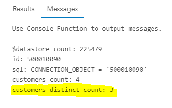

On another note, although I am using Console() in my arcade expression to check my logic, sometimes it returns as I would expect or not expect, meaning that I always don't get a function error, or invalid parameters message.  So, to me I think "okay this works" or "why is field not found?"... but, when I go thru the steps to view in the map popup window only to find out that there is no data returned!?  I wish there was a way the Arcade console could tell you (in the supported platforms) if the data result is NULL or invalid (i.e. no data returned) or to help you troubleshoot further.  For example... when using Distinct, if I only have the one field it says field not found and yet I get no data when viewing the popup, although it found the 3 distinct records... I wish it would tell me that I need ALL fields referenced in the related table.  I am new at Arcade and am learning quick, but it was a little frustrating.
var fields = ["ROUTE"];
Perhaps a more detailed error like; please add all related fields or not all fields found or something to help indicate what the issue is...
Do you have any suggestions or is that something ESRI team is aware of and working on improving?

I assume that when you create the result after distinct with 1 field, you only try to retrieve the ROUTE field and not the other fields, right? The fact that it shows the "customer distinct count: 3" implicates that the Distinct was executed correctly. A console statement that should be executed after an error occurs does not get executed.
I agree that there is room for improvement when debugging an expression, but using these console statements help to determine where an error occurs.

You are correct, I still get the error and the count results are still the same...
DonSjoboen
Xander Bakker
Using the following seemed to work better, as I could see the message returned from the Console('sql: ' + sql);
