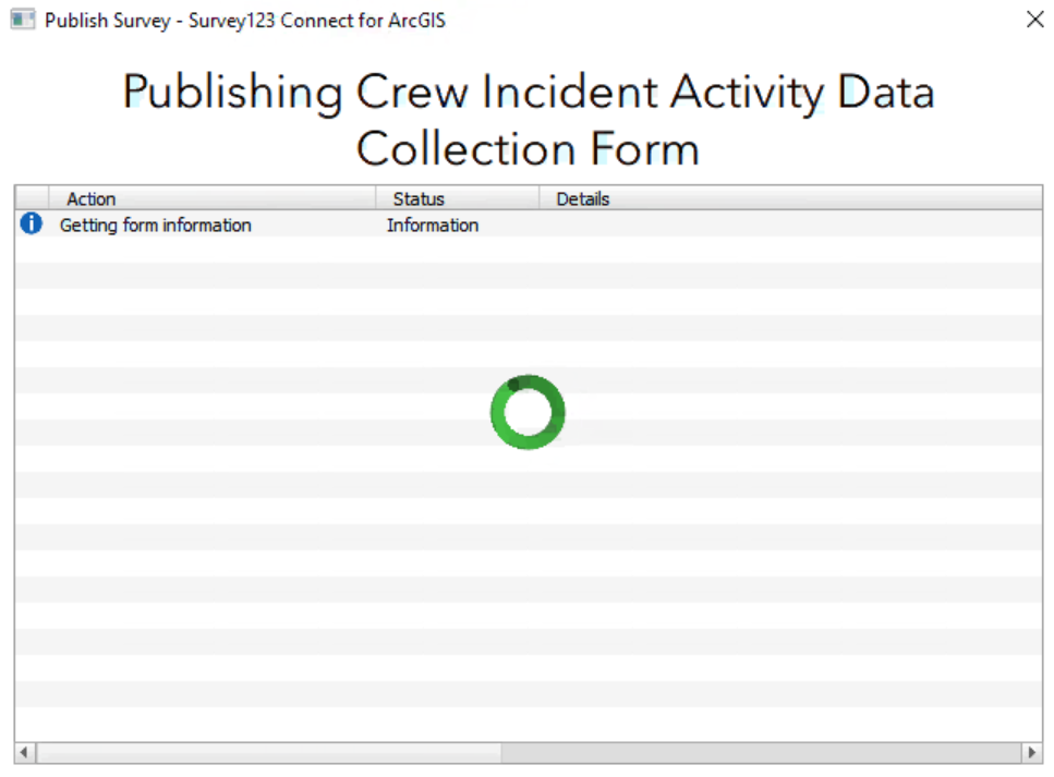

Survey 123 Publish stuck on "Getting form information"

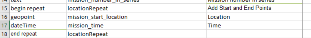

On XLSForm spreadsheet, I have a "begin repeat" section for multiple entries of resemble questions.  There is a geopoint component in the "begin repeat" section. This can be published from Survey 123 to ArcGIS Online My Survey. Everything was fine. However, if I added one more component within the "begin repeat" section, publish failed.
The publish process was stuck at "Get form information".

Did you add a new field to a repeat?  There is a old bug that causes this.  Trick is to add a dummy field to the main form and then it will publish.  Then remove the dummy.
