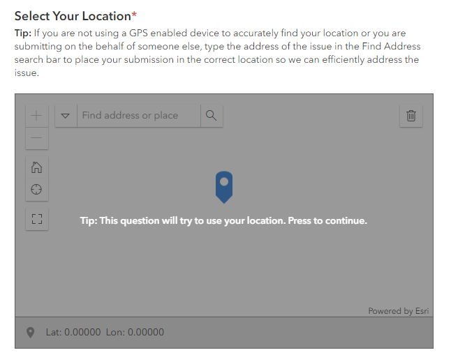

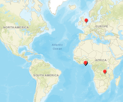

I have created a Survey123 using the online Web Forms.  Within the survey I have a map so the user grabs their correct location.  I have our locator tied to it, with the intentions being if a person sitting at a computer with out GPS or filling it for someone else than they can type in the address of question instead of the address they are located at.  The problem I'm running into is we are having address points showing up in really weird places, which I'm imaging is when a user (citizen) is not on a GPS device AND they are not typing in their address.  We are in Nebraska, USA and a few days ago points where showing up in Africa and Europe.  I've also seen them show up in other states also.  This is a citizen app so we are reliant for them to either turn on their location service off their smart device or type the address into the map.
My question is how did these points end up continents away and is there anyway I can put a setting if a point can't find a location then it place it on a certain spot on the map or at least contain it to our county?

The issue you are seeing is due to the incorrect location data being applied to the geopoint question. Unfortunately with a web browser, if the user does not enable location data to be collected for that website, we can not get a valid location. In some cases this means the data will be 0,0, which is located off the west coast of Africa, and in other cases it could be based on last known network location or some other reported value that is not accurate.
If you wanted, you could create a simple geofence square around your location, and using a constraint set the values of x and y to be within those values. You would need to use Connect to do this, and republish your survey, but it works well if you are happy to just use a simple square geofence area. If they are not in the area, they will not be able to submit the form as the constraint will stop this.

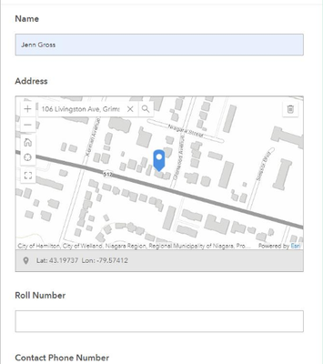

JennGross
Hi Phil,
I'm using Google Chrome (Version 89.0.4389.114).
I created the survey in Survey 1-2-3 in web designer.
In for form as I fill it out it shows this (which is the right location)

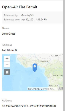

But then when I open the survey in a map or just to review the data, all the points show up off of Africa

From the information and screenshots you shared above, it seems that the submitted geopoint is actually 0,0 (in Africa) rather than the location you saw on the map before submitting.
